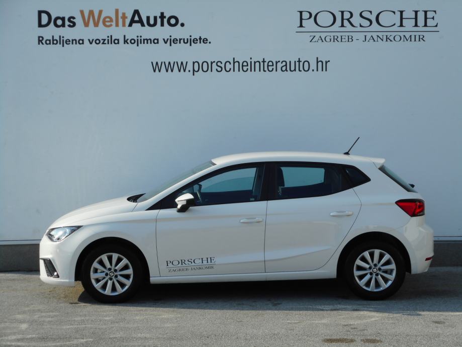

I've just found a nice demonstration Ibiza at one dealership, with ACC already built in so I won't have to mess with that. Going on the test drive this Saturday. :drive1:
Edit: drove the car. Looks even better in reality than on pictures. The radio could be bigger (it's the 5" one), the front lights could be LED, there is no double floor in the boot, but, eh, it's good enough even without those. About 2 months old and 2500 km, about 10% discount from the list price. I hope to sign all the papers next week.

If it sounds too good to be true... :shrug: Yeah, they've forgot or "forgot" to mention, both in the ad and during the test drive, that they actually can't sell the car before January. Paid an advance anyway to keep it reserved for me - I really like it.
