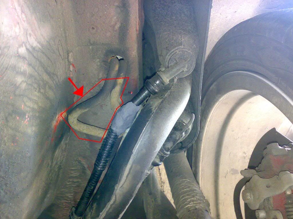

As some of you may have read i have had a fuel leak in the last day in which Seat assistance sent the AA blokey out to have a look at.
The reason my breather hose is holed is because it was above (and rubbing on) a hanger underneath the car. The AA blokey has temporarily fixed it, which you wil see in the pic...
http://i150.photobucket.com/albums/s...eatherprob.jpg
my advice to everyone is make sure your breather hose is not above the hanger that i have shown in the pic. mine is now hanging free and shouldnt cause a prob again when it is replaced.
Its worth just sticking your head under the rear bumper (o/s) just so you dont loose any petrol at some point in the future and it will save you a mountain of phone calls and visits to Seat..

UPDATE: went to Seat today.. they cant just replace the pipe, it a whole fuel tank jobby... oops.. they did say they would give me a new cupra for the day though....

I havent got it yet... i'm sure they'll come up with some excuse on the day. i cant believe Seat have designed something like that.. it seems silly to have a push in fitting one end and a tank the other.. they must be idiots
