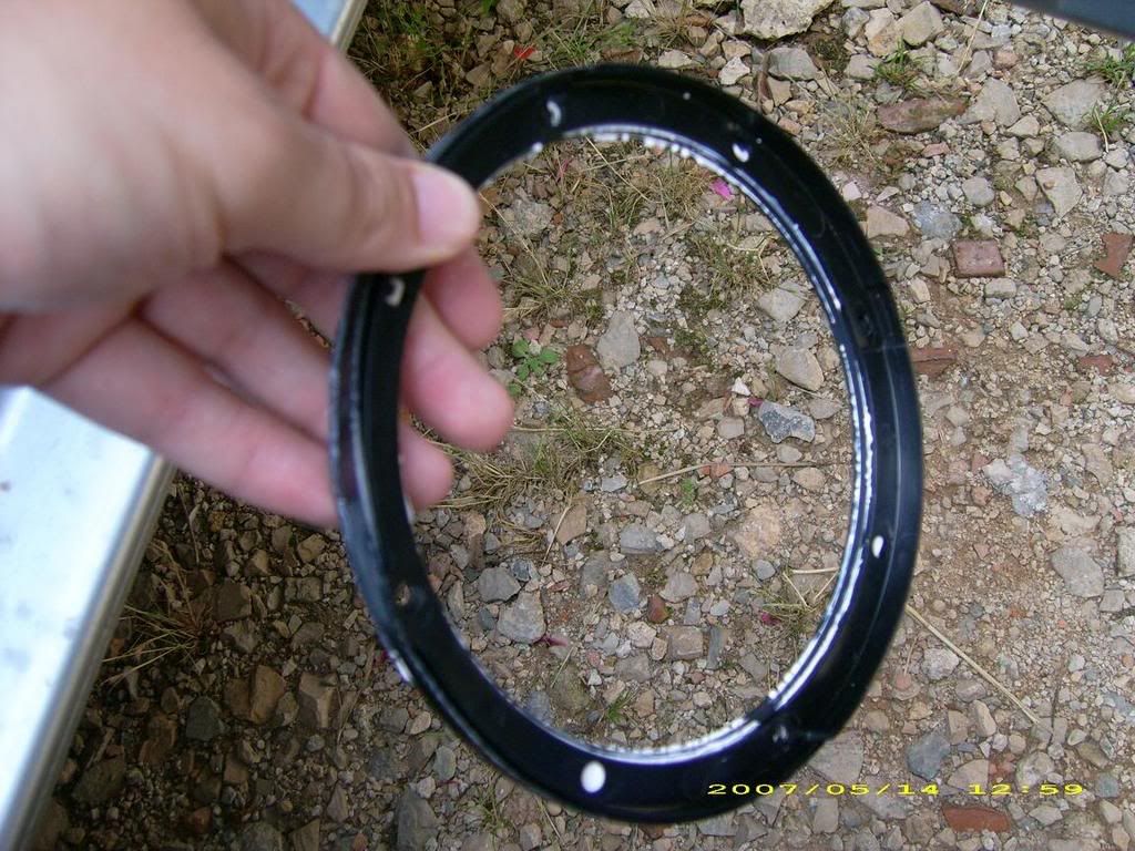

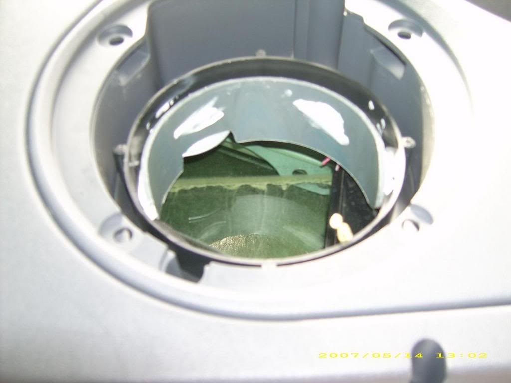

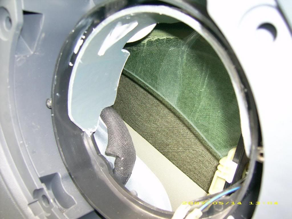

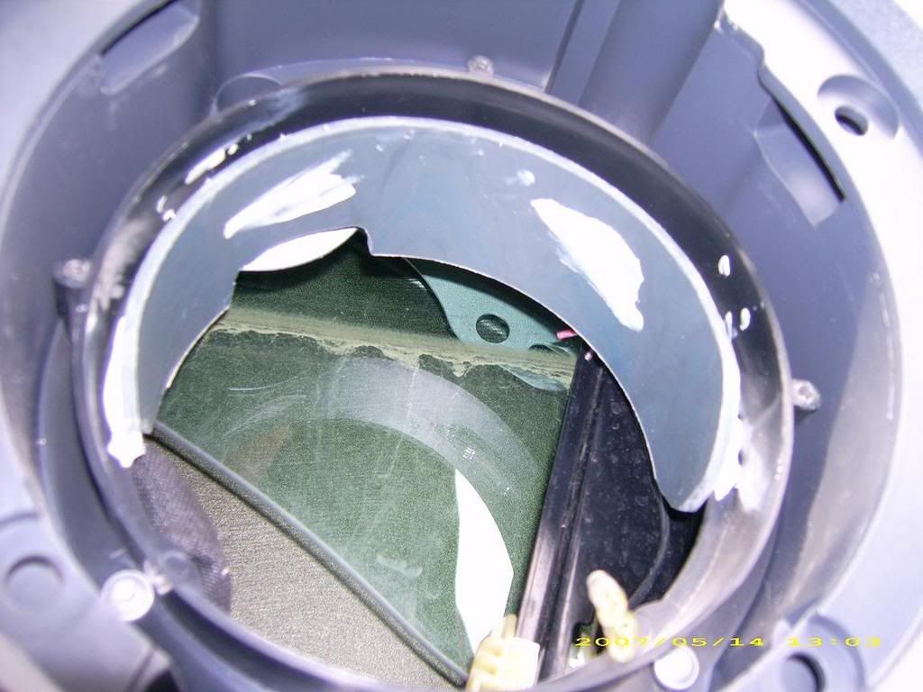

I had this problem, on both front doors. The speakers are 8 cm deep (DLS r6a), and were touching the window rail. The water was comming down all over the plastic (and still is), the speakers and inside the car. There realy is no problem with the orig. speakers because, as you to wrote, they have a lip to protect them wrom geting wet.
The seat mechanics couldn't come up with a solution so i did it myself.
First i put out the speakers to the max, about 12mm. There was stil water falling on them. Then i took a plastic pipe 16cm diameter, cut two peaces and sealed them with silicone so they cover the speakers. It's stil holding!
The other solution is to buy flat speakers.
hellowed is offline   Reply With Quote

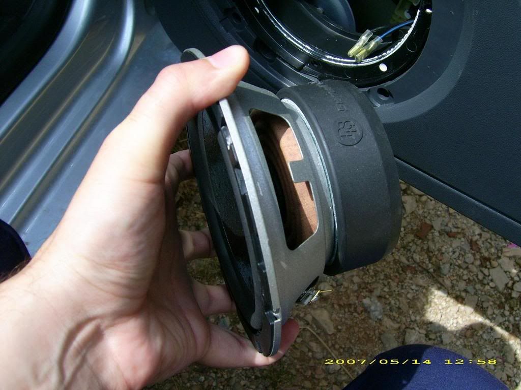

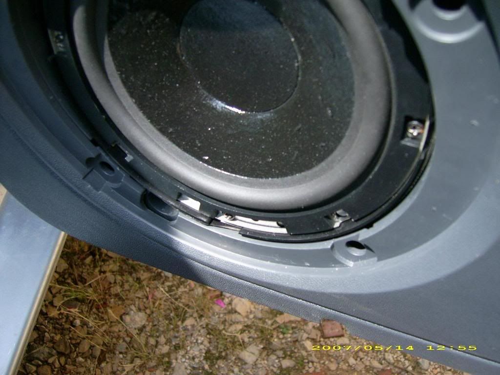

Here are the pics. It's stil not finished, but for now at leat it doesn't leak.
http://i187.photobucket.com/albums/x...t_door0011.jpg
http://i187.photobucket.com/albums/x...t_door0021.jpg
http://i187.photobucket.com/albums/x...t_door0031.jpg
http://i187.photobucket.com/albums/x...t_door0041.jpg
http://i187.photobucket.com/albums/x...t_door0051.jpg
http://i187.photobucket.com/albums/x...t_door0061.jpg

Well hellowed looking at the pictures the speaker adaptor you fitted is not the Golf IV Autoleads Sak 3103 unless you got carried away with a hacksaw
You seem to have a slither of an adaptor ring:
I'm wonder whether that is your problem.... LOL. You note that the Autoleads one as per the project that I published on the Altea site that kicked all of this off, has a cover and that is what people have been fitting to their Leons
http://www.seatcupra.net/forums/showthread.php?t=53080
Is this the Blaunpunk 7606500150001 by any chance ?:
I reckon they are which may explain the water less protrusion at the back.... your pick:
We need someone to shows their picture with the SAK3103 [Loadwine's one had vanished again....]
So I still think that the Autoleads SAK 3103 does a better job .... and you get free connector leads... and a drain pipe is not required .

What's the laughter for? Golf V adapters are mounted on. Can't you see it on the pic Tell? The adapter I have in hand is to put the speaker out max. to the grill.
So... golf adapter + 1cm adapter, and the speakers stil got wet. I had to go with the pipe.
No Autoleads SAK 3103 will help if you have the same problem I have. Or, as I wrote before, you can buy smaller speakers.
Not all Leon05 have this problem. On ones that doesn't, golf adapters are probably enough.
