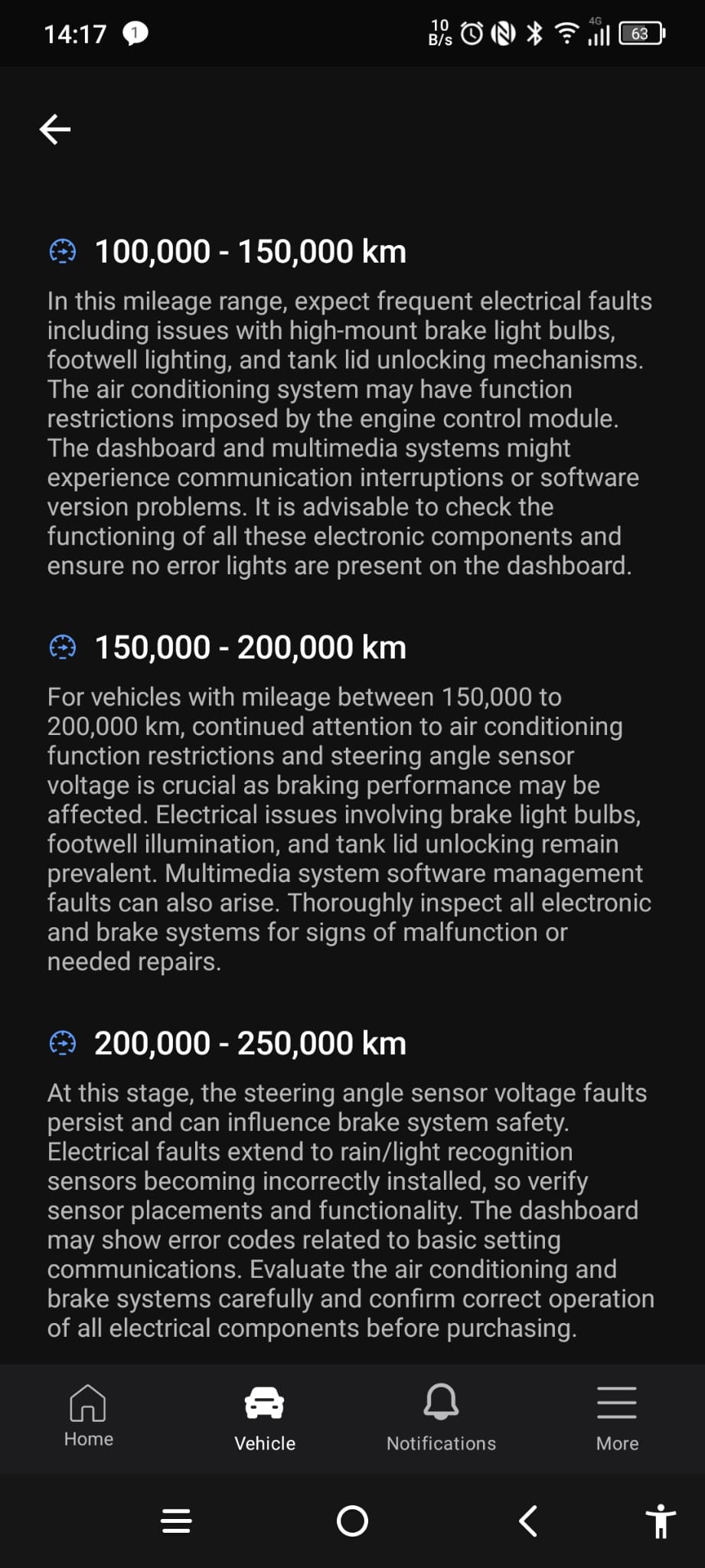

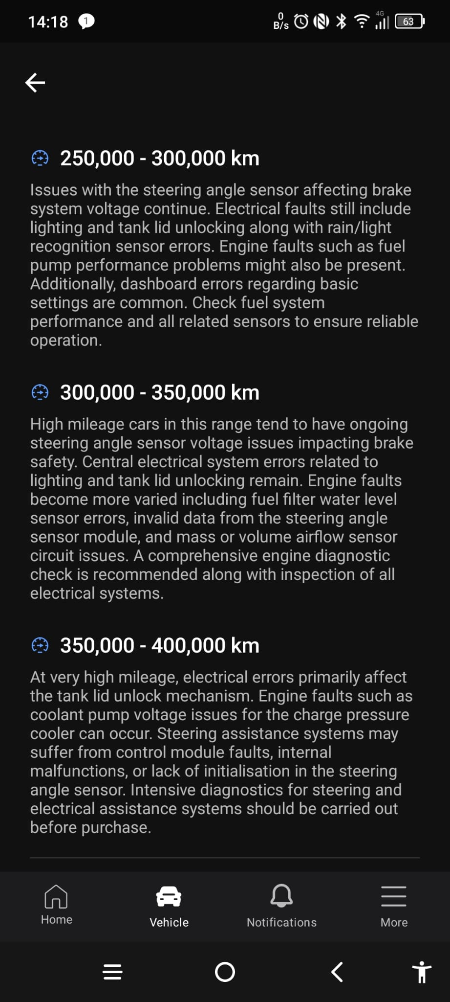

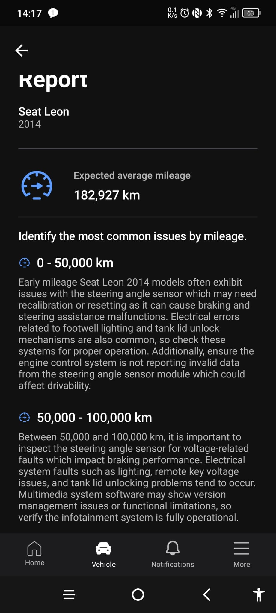

The following information is from the OBD11 Car health report under Car buying assistant
