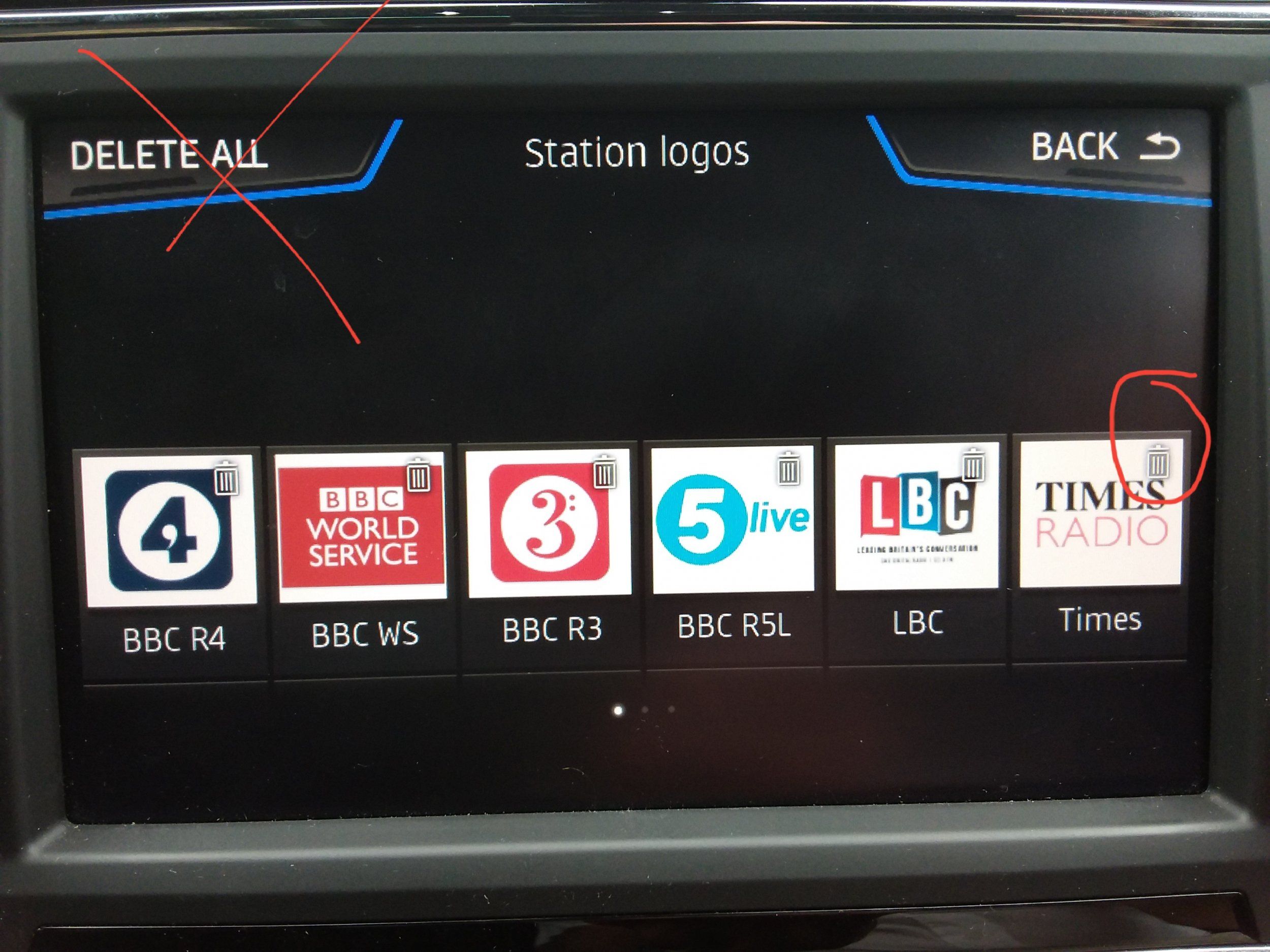

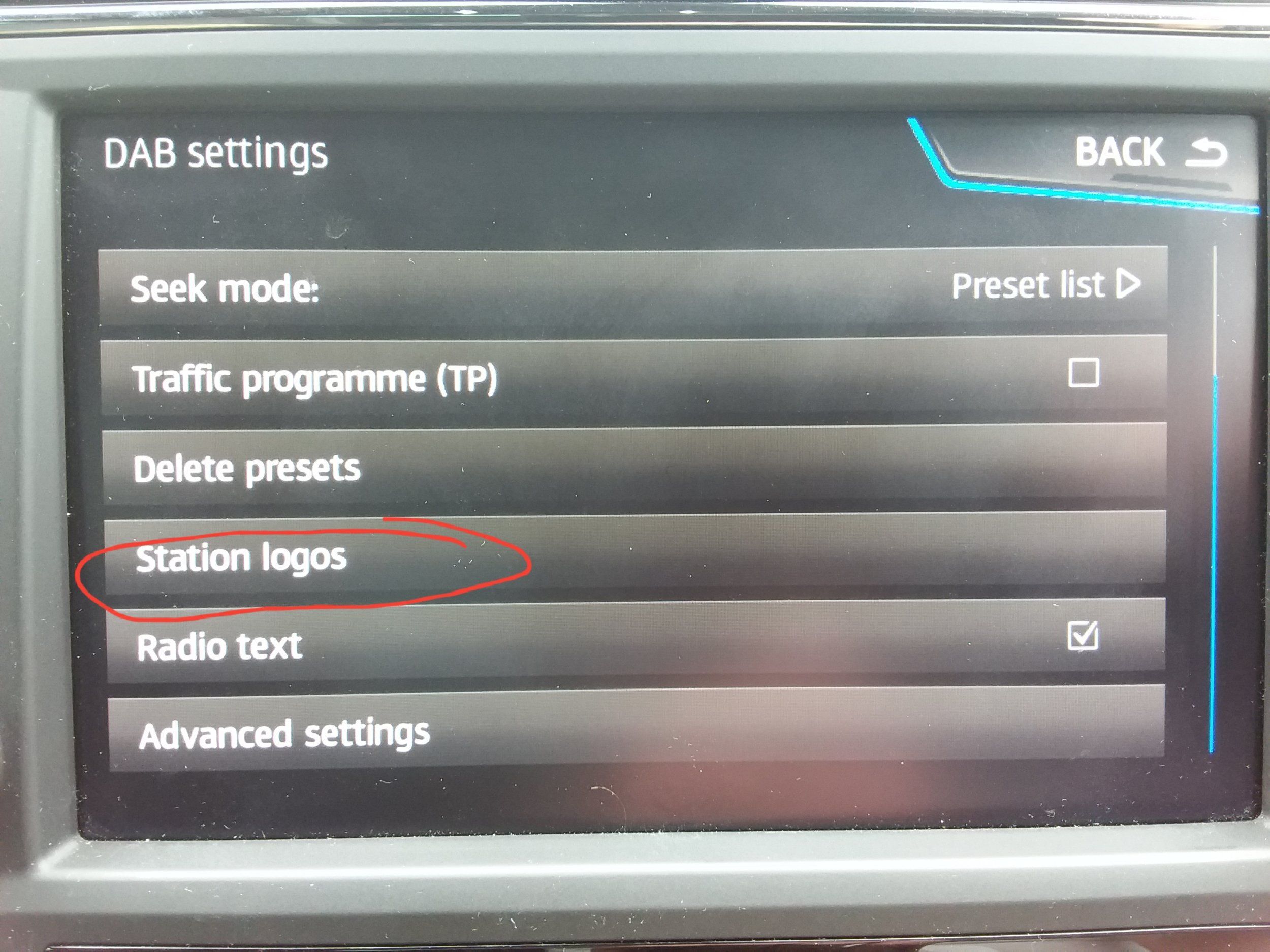

The Seat import is slightly different. Get the station up on the favourites then press settings and go to Logo down the bottom, do not press delete all (tab), that will delete all logos. Dependent on whether it's picked up a logo or not, if no logo you installed, install the logo from the menu, if there is a logo but not the right one (current issue with Times Radio), just delete the logo and import the new one. (where you don't delete all logos using the top tab... some people do and then make work for themselves).
