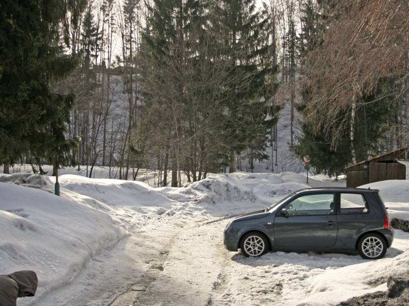

It's completly different tuning firm and completly different car.
This Lupo is FWD. With 1,9 was Blue and now with 2,0 is Grey.
This car is pure diesel without lpg or something.

Still impressed with the 2.0 TDI engine in the lupo. How is the engine management done? Is it stand alone, or did you manage to use all the electrics from the 2.0 TDI original car?
Good videos! :D
CompSport
In the begining it was 1,7 SDI. then we change the angine to 1,9PD and 6 Speed gearbox. We had to change the electrics and use the EDC15P ECU.
When we install 2,0 16V PD we had to modified the G28 Sensor (crankshaft positon sensor), G40 (camshaft position sensor) and we made it.
Our BKD is runin on EDC15P ECU, not like in a new cars on EDC16.
But the program is compleatly new only for this car, for example we are runin without air mass meter.
The fuel quantity is from the boost pressure.
