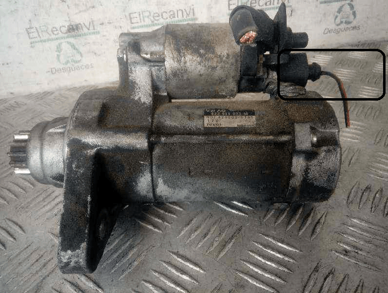

Hello, I have Ibiza 1.2 tsi from 2014. The problem is that the starter does not spin, and the controls work properly. Good battery and there was an attempt to start from another car and no changes. I have an OBDeleven and VCDS application. What could be the reason? He has traveled 68,000 km.

Maybe forget about scanning tools and try to get the starter to operate by powering the solenoid from a temporary suitably fused wire from the battery, if the starter does now operate as expected, then at least you know it is just a control wiring issue. I'm guessing that you are not getting any warnings about the clutch pedal not being pressed fully down?

Could you draw in the photo or indicate how to check the starter?

maybe even try to disconnect the connector and conect again...
tip: you need to push the red part of the connector in the direction of the wire to unlock it, and then again while removing the connector.
a bit differente here, but some example:

Hello, sorry to speak up now. The car has been repaired. There was a broken cable to the starter.
