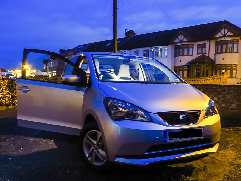

Well would you believe it.... Enterprise didn't have any cars left either!!!
SO they have actually let me take one of their sales cars as a loan car. They don't usually do that.
It's a 62 plate Mii and had only 26 miles on it. It still had the price stickers in the window, but it does have a tax disc so I'm OK there. I've always fancied having a go in a Mii. This one is an auto... which was OK except I couldn't quite work out the semi auto box when I somehow managed to shift it into "manual" at a roundabout with a motorway slip road coming off it.. trying to drive up the slip road in first while fighting with the gear stick (counter intuitive to a manual driver to push the stick forwards to change up from first to second) was interesting... eventually got it back into full auto and I was away. Quite like it... it's fun!
Here it is:
