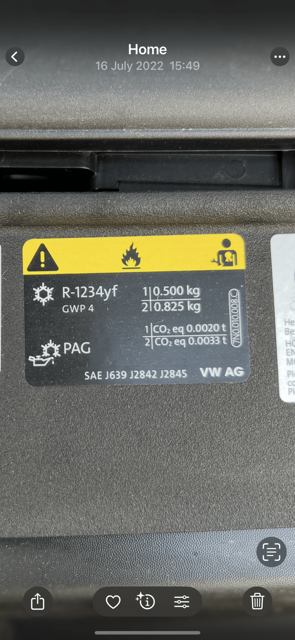

Hi I’m going to get a regas but on the label in engine there are 2 figures 1-0.500kg and 2-0.825kg , which one is it ?
my Alhambra is a late 2017 with 3 zone climate control ,
all I can see is just the 1 set of refill pipes in engine for High and Low so why is there 2 figures
thanks in advance

There are two figures for if the vehicle has a front or front and rear air conditioning system.
The lower amount for just front A/C and the higher amount for front and rear A/C.

I see thank you , so as I have the rear controls for ventilation system it must be the higher one ?

The easiest way of clarifying is by PR number or having a look under the vehicle for additional A/C pipework going to the rear.
