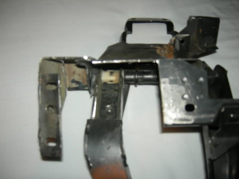

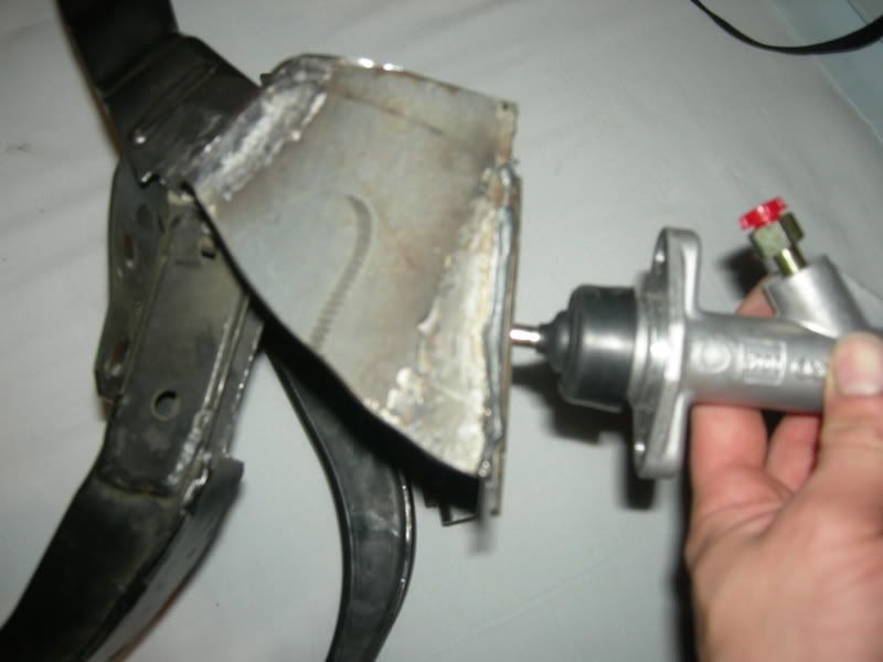

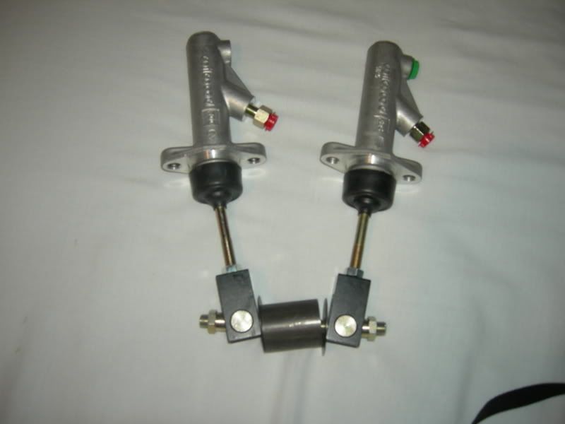

the balance bar assembly
where the master cylinders need to sit
the mods to the pedal box so far till i get some more steel
