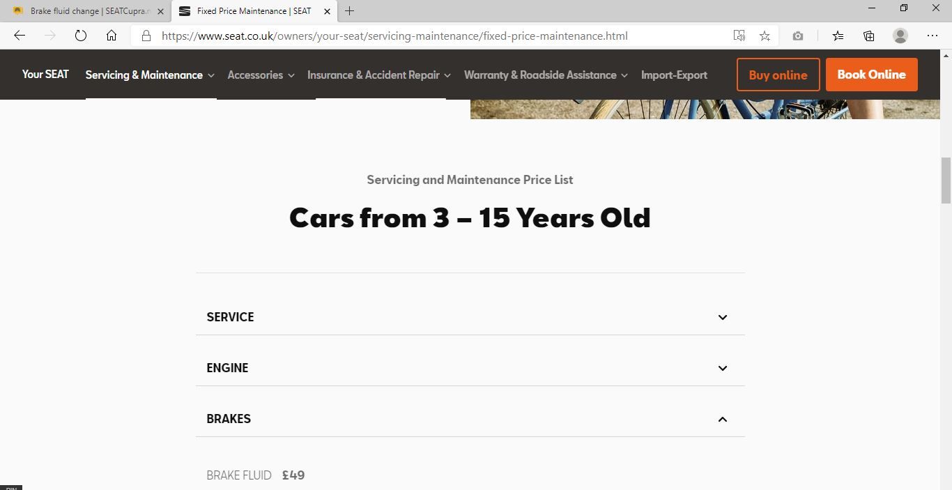

VW currently charge £69 for a brake fluid change, so £65-£69 or thereabouts would seem to be the going rate.

Last year my dealer rang me when I put mine in for a service and said the brake fluid needed doing, I asked them to knock the price down a bit and ended up getting it done for around £40 odd quid.
No harm in asking if you are in the same position and having a service done at the same time too.
