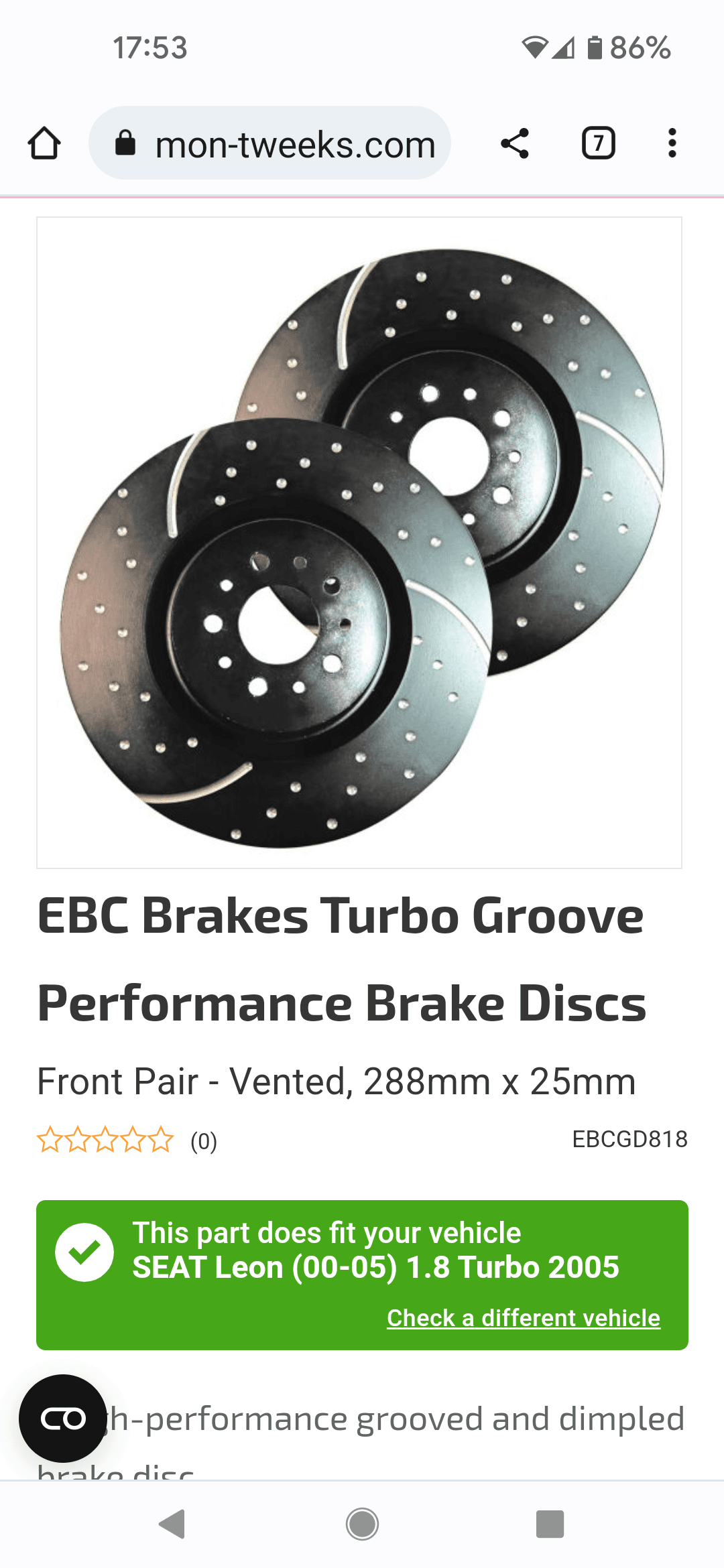

What might these be like for £166 squid

Ok, with info provided, here's my advice...
Save money on discs / Spend money on pads
The Godspeed stuff is excellent but far beyond what's necessary for the usage you'll put them to.
Get some plain discs, whatever you fancy but cheap isn't necessarily bad (I run Eicher which is amongst the cheapest of brands and treat them hard).
Pads... without going full race pad like the DS2500 etc, Pagids are not a bad shout but maybe an upgraded pad like Ferrodo DS Performance or EBC Bluestuff for a little more confidence in all conditions

Whilst I'm not saying they're the best option (I don't have experience of their discs), we do get 10% off EBC stuff as they're a forum sponsor.
The reason I say go for plain rather than the slotted/grooved/dimpled/drilled discs is because the latter are for looks unless you plan on repeated heavy braking. I mean if you want the looks go for it, nothing wrong with that 👍
