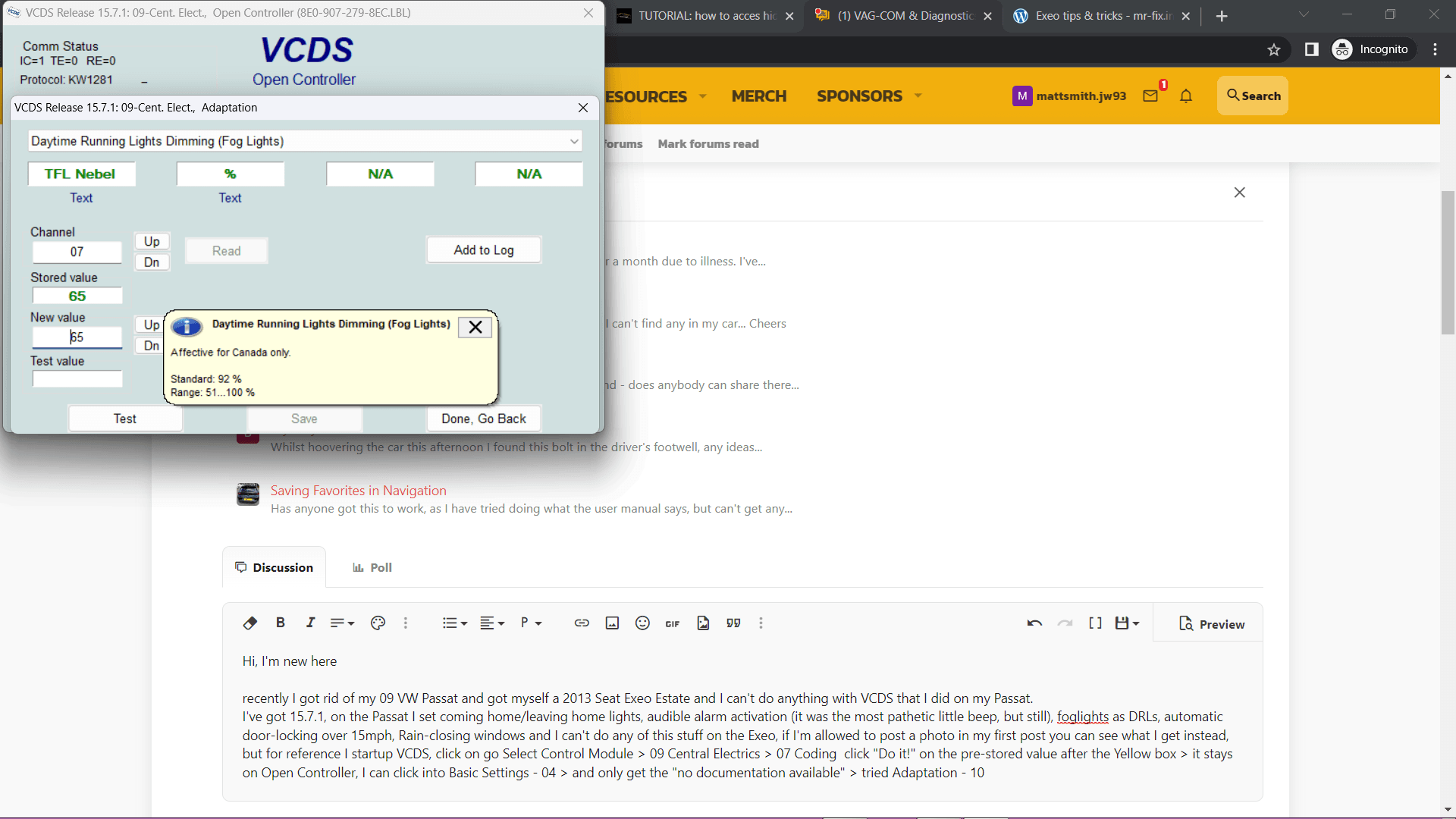

recently I got rid of my 09 VW Passat and got myself a 2013 Seat Exeo Estate and I can't do anything with VCDS that I did on my Passat.

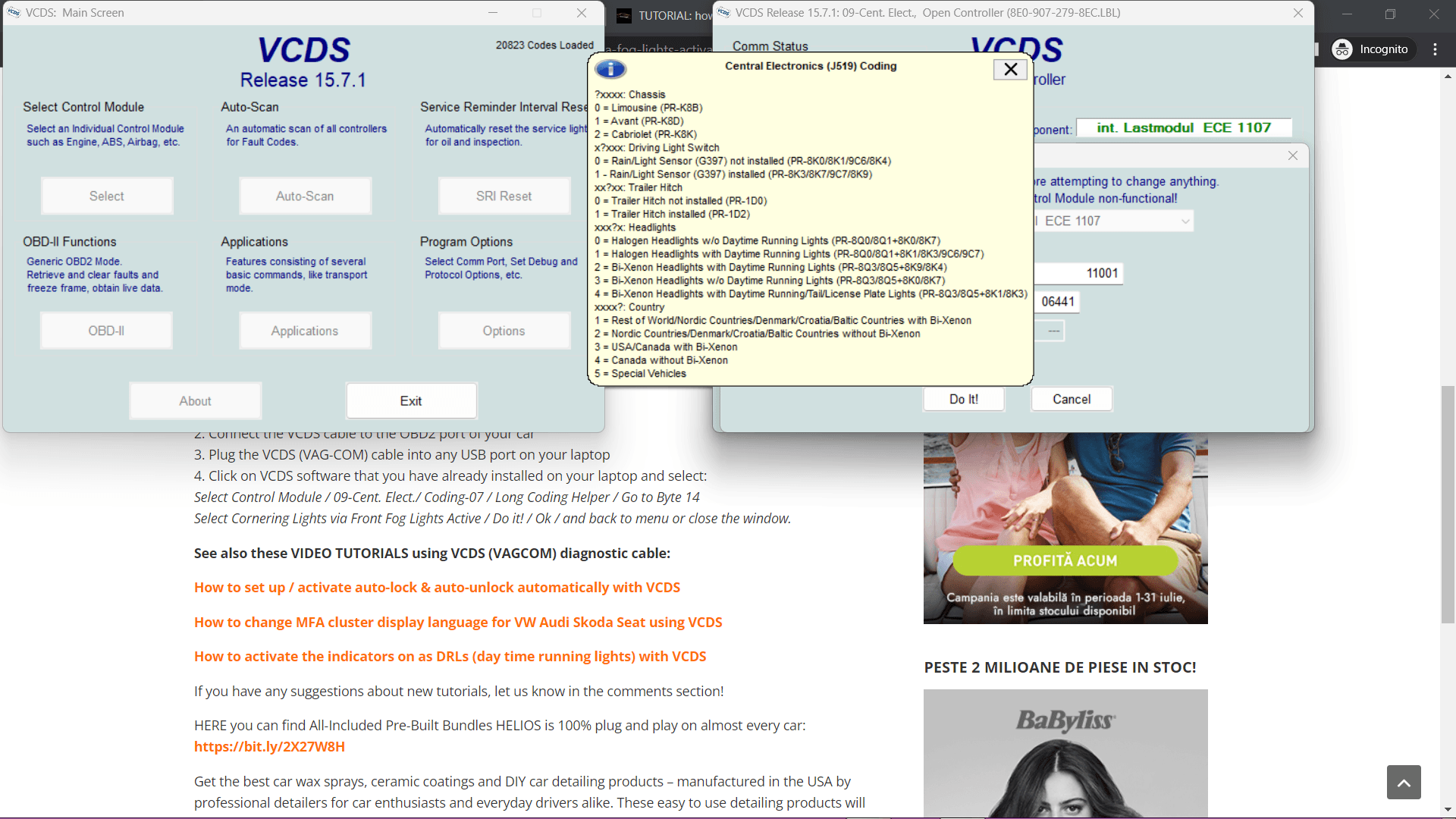

I've got 15.7.1, on the Passat I set coming home/leaving home lights, audible alarm activation (it was the most pathetic little beep, but still), foglights as DRLs, automatic door-locking over 15mph, Rain-closing windows and I can't do any of this stuff on the Exeo, if I'm allowed to post a photo in my first post you can see what I get instead, but for reference I startup VCDS, click on go Select Control Module > 09 Central Electrics > 07 Coding click "Do it!" on the pre-stored value after the Yellow box > it stays on Open Controller,
I can click into Basic Settings - 04 > and only get the "no documentation available" > tried Adaptation - 10 "Daytime Running Lights Dimming (Fog Lights) but the lights don't stay on.
I tried a load of other stuff too but nothing takes effect.
