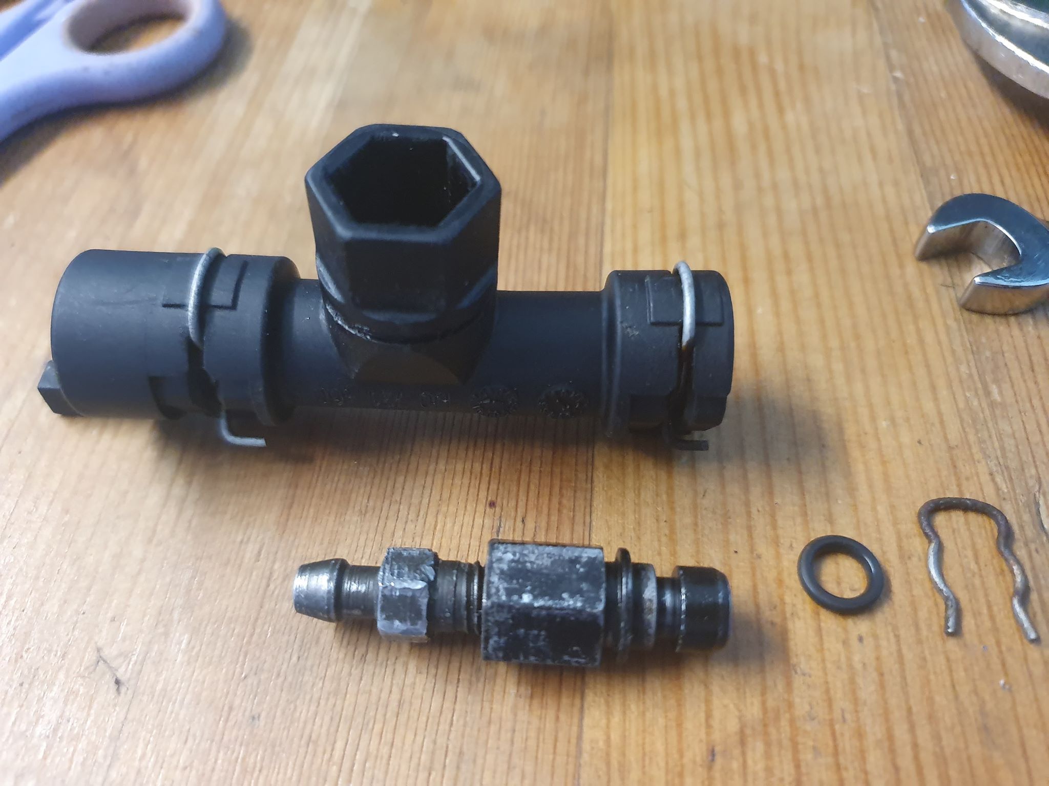

I had a similar problem recently. I'm not sure if the tdi has the same bleeder type as my cupra, but there is a t-piece near the slave cylinder with a bleeder valve on it. Check to see if it's wet around the bleed nippe. Give it a wiggle if you need to.
I changed my slave cylinder, clutch while I was there, then the master cylinder, until I found out it was this thing. If it is don't even bother trying to replace the o-rings like I did for more frustration. It's about £20 second hand on ebay if it's your problem. Just make sure to go off part number and check the connection type, the replacement was slightly different for me, but it came with the different pipe attached.
