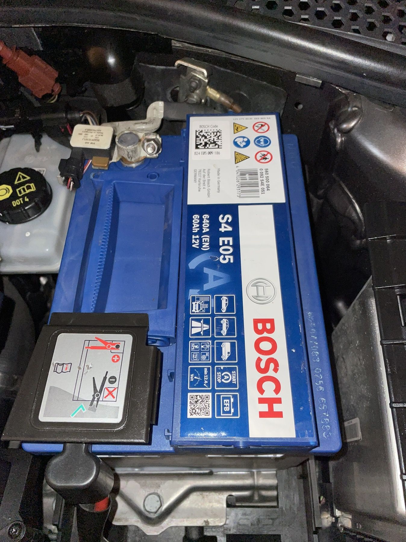

The dealer change the batter with the attached one as the car stayed a lot days with empty battery. We are facing some strange problems with many things.

Battery specs: Capacity 60h - ACC 640A -Type EFB.

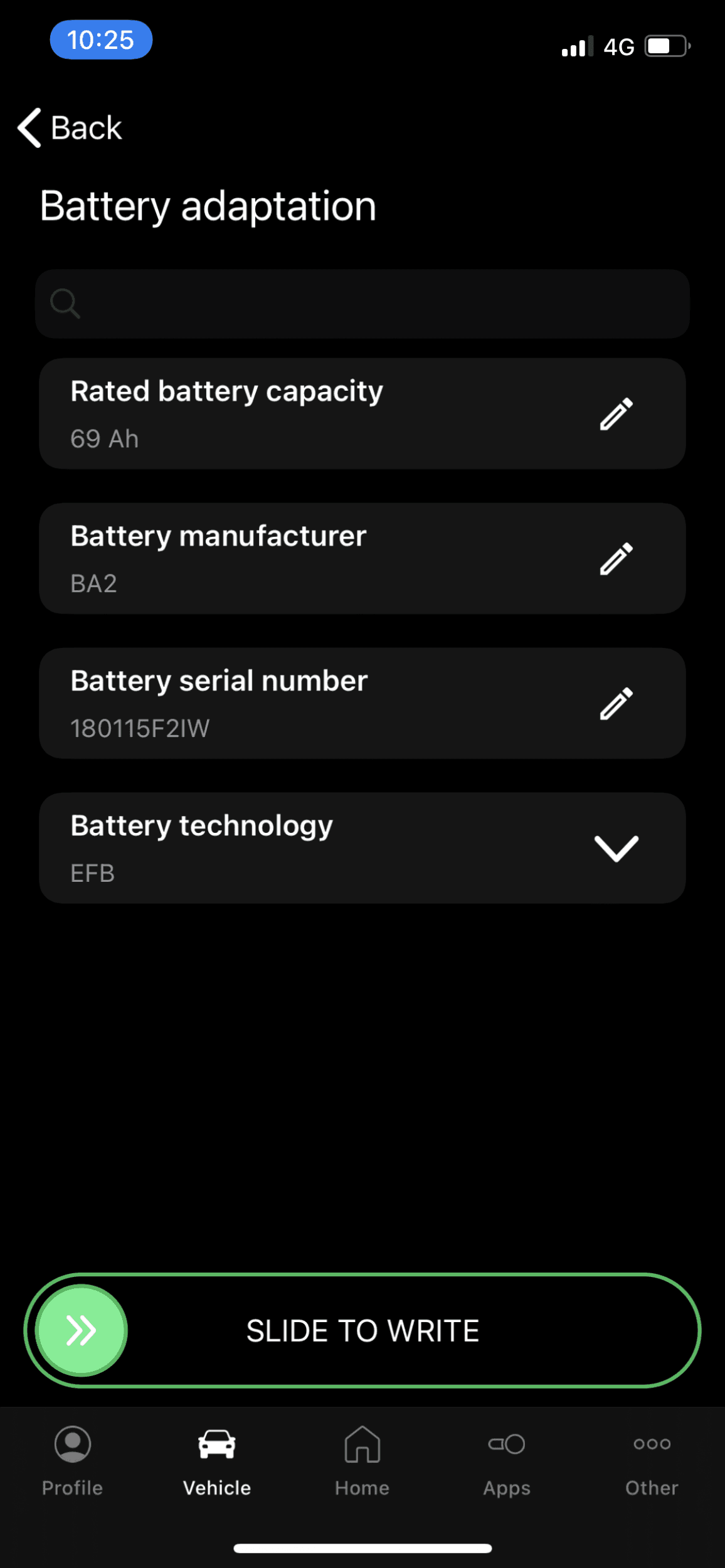

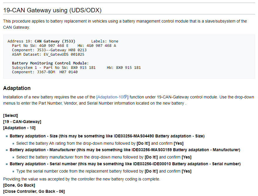

Yes, I coded using VCDS and attached procedure according to battery details but with no luck.
Should the S/N be 9-digit or 10-digit?
As far as i know S/N is not critical to be coded... I mean it doesn't change anything..

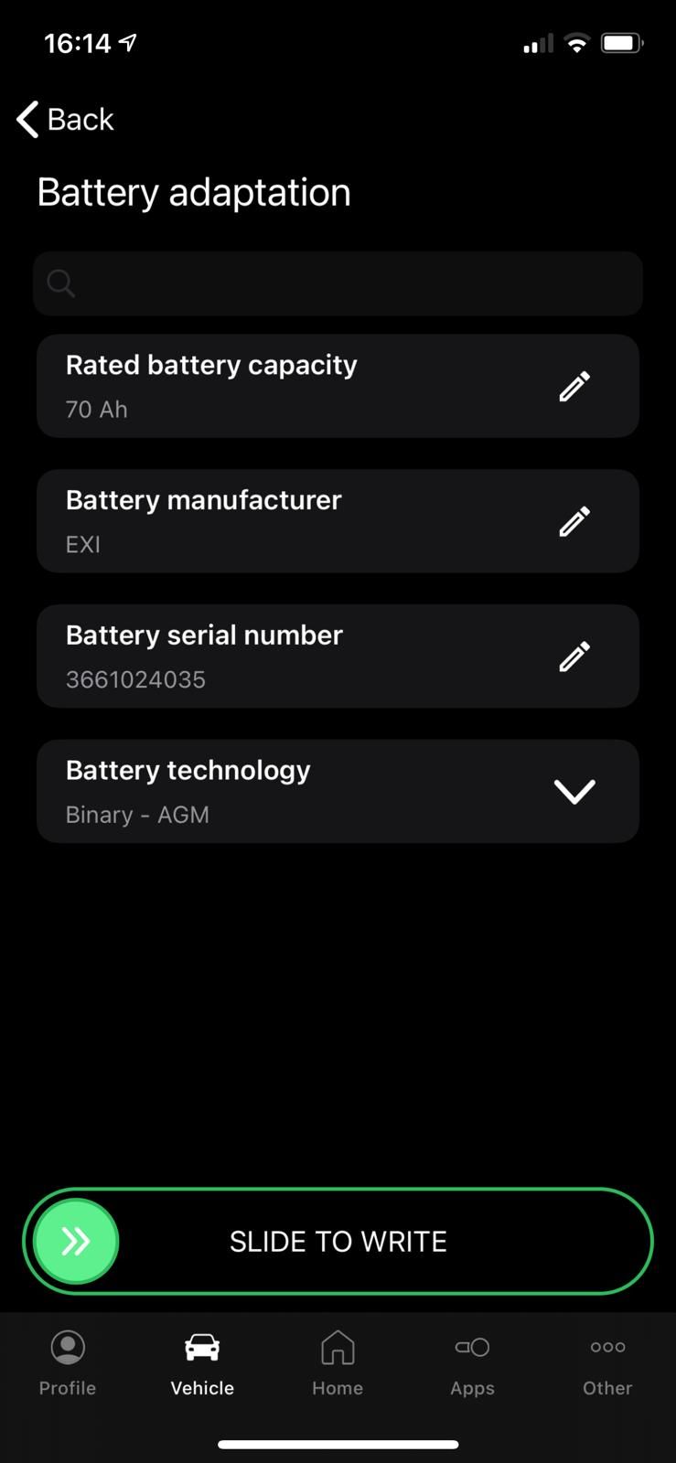

Yeah I used OBDELEVEN to change the settings, otherwise the car tries to charge the battery as it did the previous one. You can do it in VCDS too.
I changed from EFB to AGM though. The manufacturer should stay as VA0 (I didn’t get a screenshot of it being corrected back to that). Some people say you just need to make sure the rating is set correct and then change one digit of the serial number for the car to realise you have a new battery.
