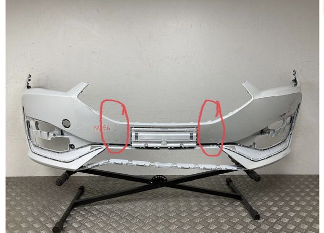

Good find. I wonder if anyone is up for trying to plug the holes with colour-coloured plastic plugs - that might be a reasonable alternative to painting the whole bumper just for a few small holes. E.g. https://bumperplugs.com/bumperplugs-for-volkswagenI found pictures of a used mk4 Seat Leon bumper for sale on eBay - see below. Not a Cupra Leon bumper, but I dare say the manner in which the number plate holder is attached to the bumper would be the same. You can see in the picture that there are four holes (circled) where the fixings for the number plate holder pass through the bumper cover. They are quite widely spaced, so if anyone were to remove the number plate holder and fit a smaller, shorter number plate, then those holes wouldn’t be covered by the number plate. It would be necessary to get the holes filled and that section of the bumper (or the whole bumper?) repainted.

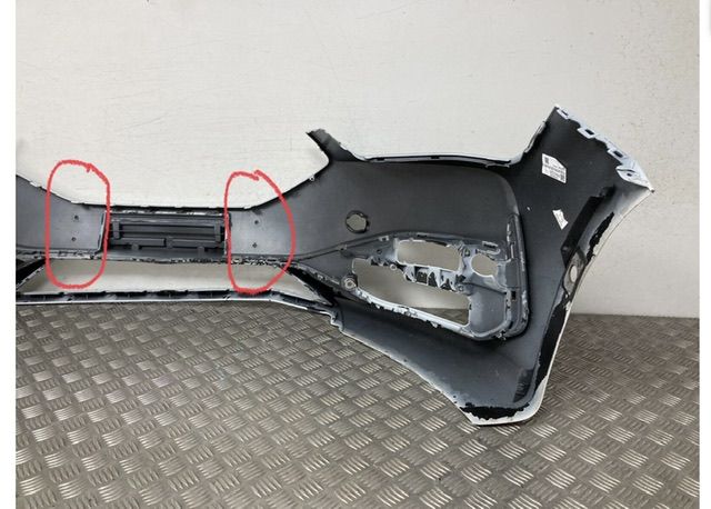

Reverse side;
