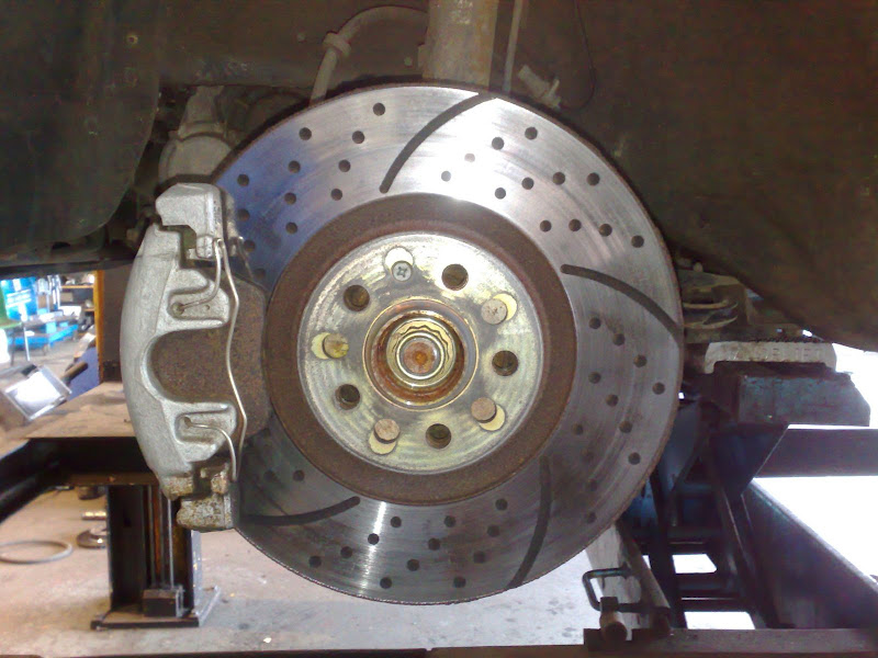

Driving down the road about a week after buying it and hear a crumbling noise while braking. It got worse and worse. Drove to ATS for one of their Free brake checks....
Learnt two things:
1) Brake pad material had separated from the brake pad plate and had essentially broken up and fallen out. Needed new brake pads and the discs became scored, so they needed replacing too.
2) Brakes apparently weren't standard for my car. Not sure if this is true or not?!
Here's a pic of the old discs mounted on the car while up in the air at ATS...
Anyone know if these are standard?
Also to note is that the wear was much heavier on the drivers side than the passengers, but that both were in a pretty bad way.
ATS reconned that the brakes I should have on my car as standard weren't grooved or drilled and were only flat, so I said i'd investigate. I wasn't prepared to replace performance brakes with non-perf brakes, cos they'd obv been installed for a reason.... like the standard ones are crap, perhaps?!

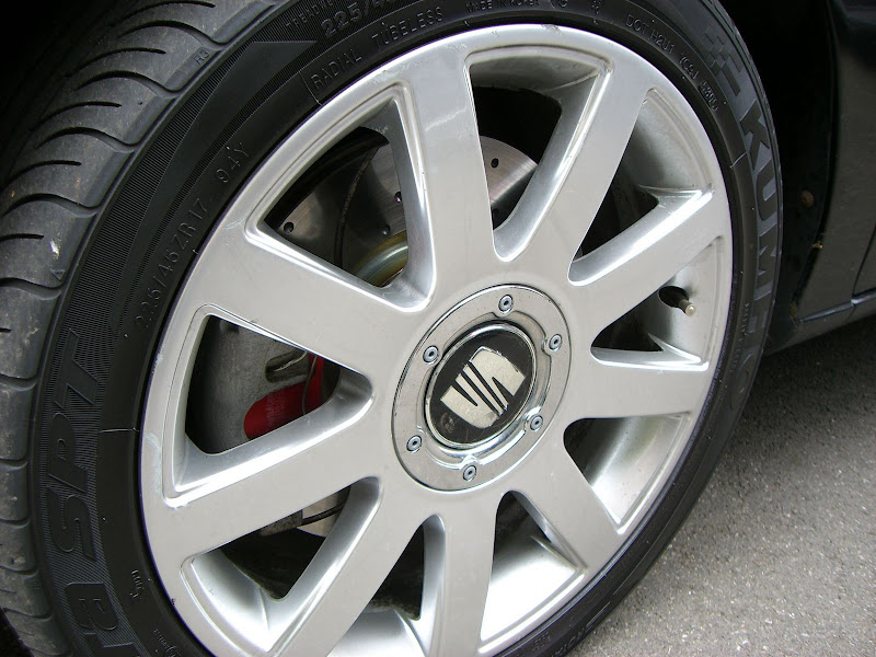

Installation was a breeze thanks to a thread I found on this forum, and with the addition of some copper grease in the right places, should be even easier next time. The biggest problem was starting in the evening, losing the light and freezing my nuts off!
The nice thing about the new pads is that they are bright red on the back, and this shows through the alloy as I drive, although not as obv as the red brembos on the LCR, they still look nice. See...

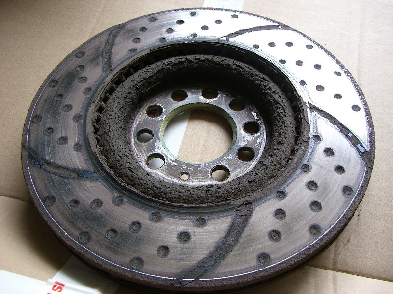

Oh and the old brake discs + pads, yeah they were in a pretty bad way....
Close up of scoring
Back close up
Back of disc

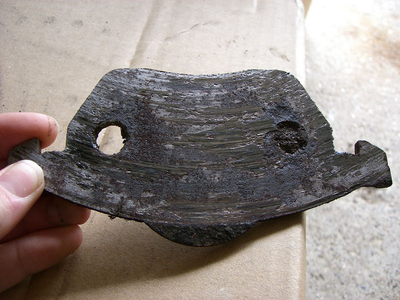

Leftover of pad - yes that is the side which is supposed to have pad on it!

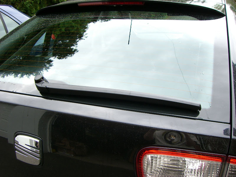

Ok, so with a lot of reading on this site in numerous different threads I decided to take the plunge and change the rear wiper. I needed a new blade anyway, so it seemed like a good opportunity to get it done.
I decided on the Skoda Fabia rear wiper as it looked better than the standard and I prefered it to the Aero design. I just think the back of the Leon looks big, chunky and muscley and the Aero was a bit weedy getting smaller at the end. The fabia wiper looks great!
Such a simple mod as well. Only one 13mm spanner needed to take the nut off!
£17.83 Total cost + 5 mins of my time.
Partnumber / Description / Cost
6Y9955707A Wiper Arm (Estate Model) = £10.16
6Y6955435 Trim (Hatchback Cap) = £1.53
6Y0955425 Rear Wiper Blade = £3.48
VAT = £2.66
My experience...
Allams Skoda in Epsom (Longmead Estate) were very helpful. They raised an eyebrow or two when I told them I wanted hatchback and estate parts, but understood when I told them what it was for.
I had a couple of problems...

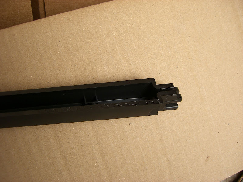

Firstly, the wiper arm arrived without the spring and metal connection, which explains why it took a while to work out how to connect the cap! The parts guy even dared to question the knowledge of the forum users!
I told him it couldn't be right and that I wanted another one ordered in to see if it was different. He didn't mind this at all, as he was a little confused too.

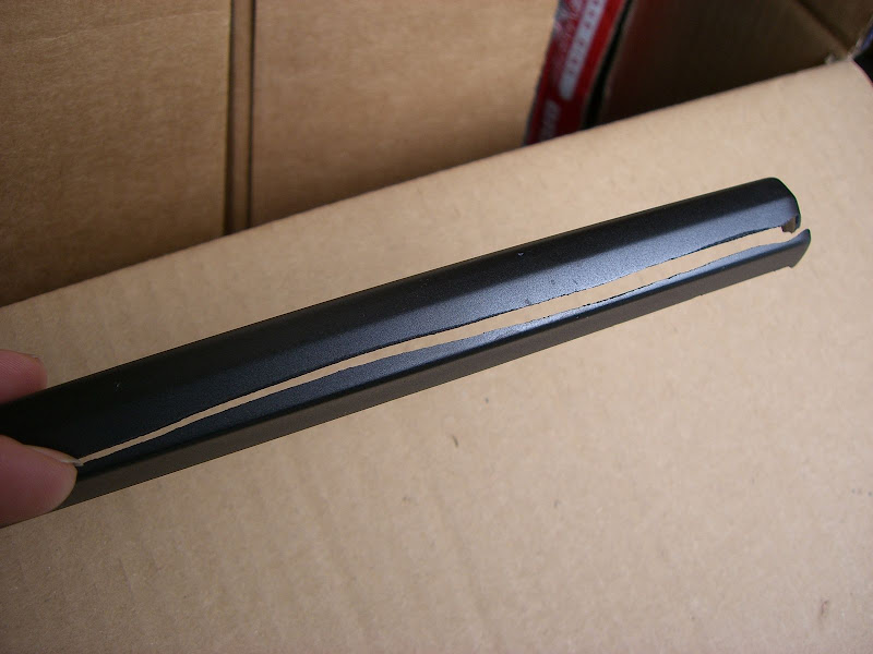

That one arrived and the end was split...
but it did have the metal connection and spring, so I took them both and swapped the ends over..gently!

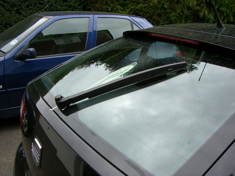

Like I said, one 13mm spanner and a little care was all it took. Here are the before and after shots...
Before..
After..

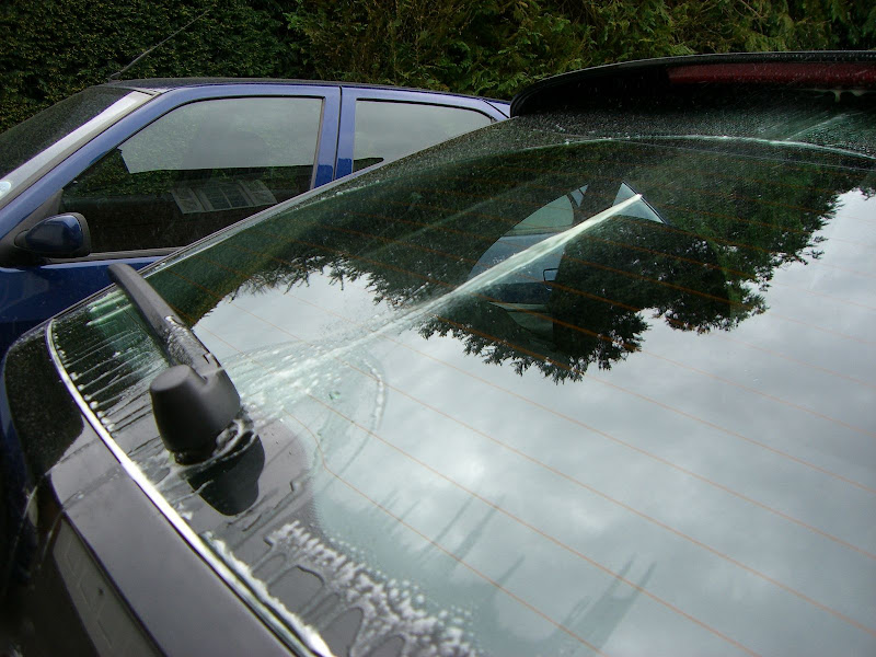

One downside to the new wiper
I can't remember if it did this with the standard wiper or not. It must have. There can't be any other way. ?
No explanation required really just look at where the water jet hits the wiper in these pics.:doh:
Makes a bit of a mess when you have screen cleaner which foams up a bit.
Oh well, still looks better than standard! :rolleyes:
