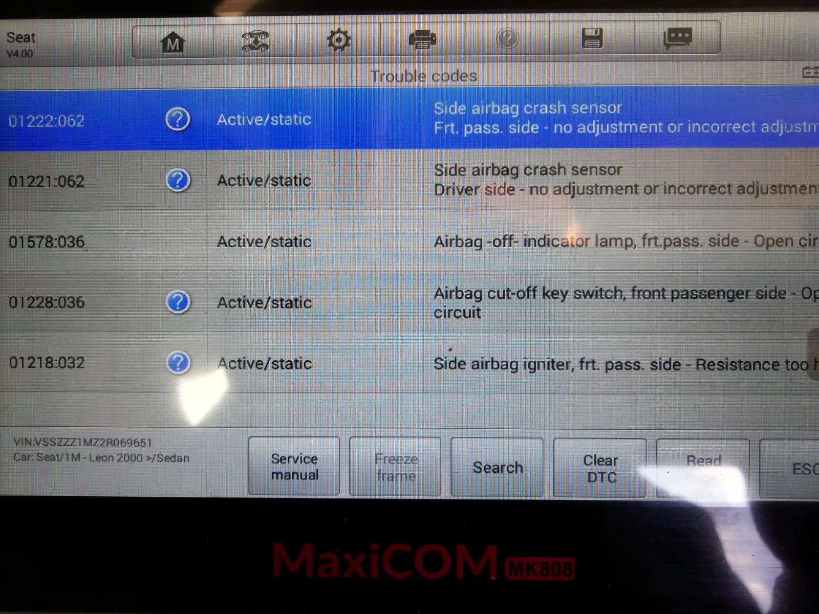

So I have a 20vt which had the usual water ingress problems and airbag light stuck on. Doors have been sorted car is leak free and "EVENTUALLY" dried out. Today my mechanic and I tried to fix the airbag light issue. After reading previous threads I purchased sensor 1C0 909 605 A and swapped it over. My mechanic said this is the one not under the seat but more towards centre between both footwells around the heater area.
It didn't resolve the issue but apparently opened up some new codes. Which I will try to attach. We also pulled the passenger seat out and checked the one under the carpet. This one looked brand new condition. Any help advice greatly appreciated guys thanks
