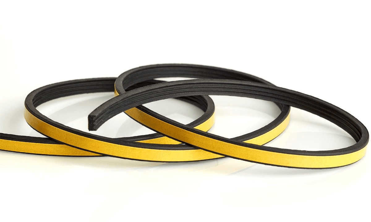

I had the same in my 2018 Audi S3. The vibration came from where the plastic panel on the inside touches the metal part of the door.
I ended up sticking some of the below rubber band (used for windows in houses) on the metal part of the door while lifting out the plastic. This made the plastic sit tight and not touching the metal - and bam the rattle was gone! (Please see my fine illustration below of where I put the band).
if the dealership does not fix the issue i will for sure try this
