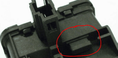

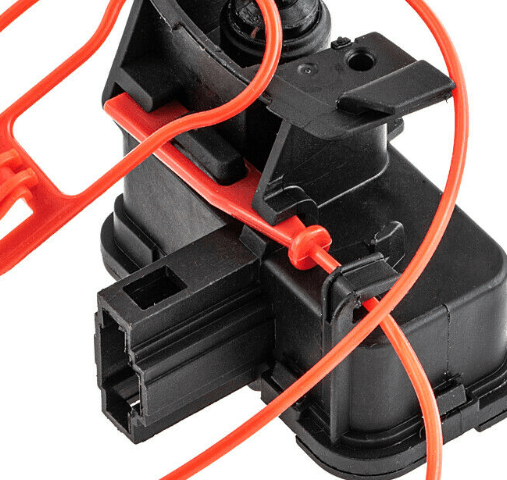

There is a protrusion - circled red - which can be for a red plastic emergency access pull cord - through not sure my Leon has this? Maybe could be retrofit and left in the boot somewhere?
Yes looks like the Audi version 8F0862153E includes the plastic pull cord!Defo no manual release on the Leon. If it is the same part minus the red cable, for the sake of a few pennies it makes you question the logic of not fitting it, considering the agro it can cause? I get that penny savings matter on large scale production but really? Premium feature / brand hierarchy maybe? As it happens, when I was stuck on the forecourt unable to put fuel in and furiously beating the flap in the hope it would open just one last time, another driver did come over and say "oh, haven't you got a release in the boot?". Didn't look but they probably had an Audi..........
