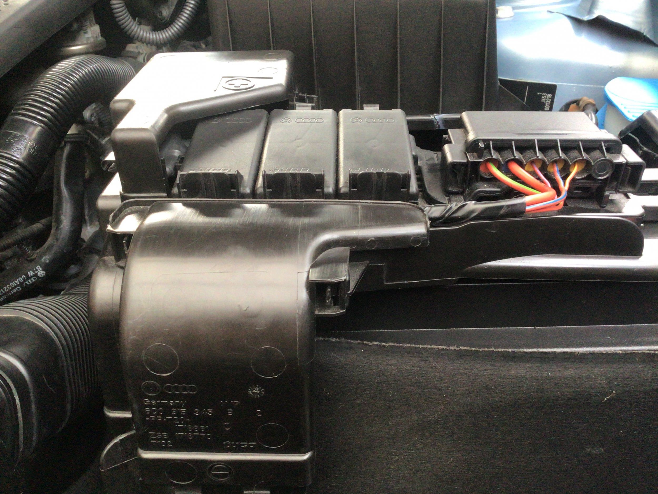

You don't need to take any wires out, the top assembly unclicks and rotates and then lifts away far enough after you have unbolted the battery +VE post.
Or do you mean that you are changing this top part as well?
So breaking up the old top's plastic will do no harm, when you compare this old one with the replacement you might find out a lot, maybe this section plugs/unclips?
