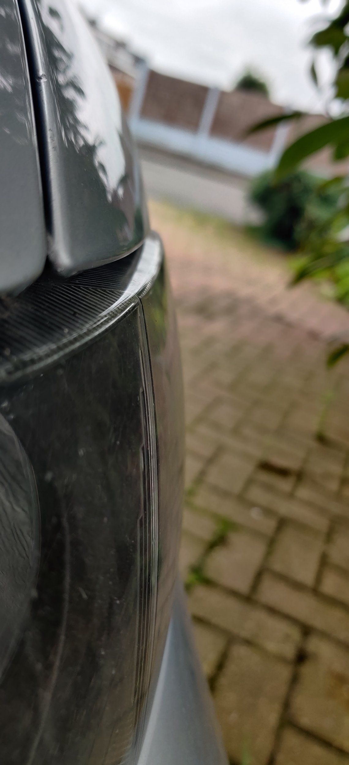

Would you know if there is some room for adjustment? The passenger side doesn't sit right see attached

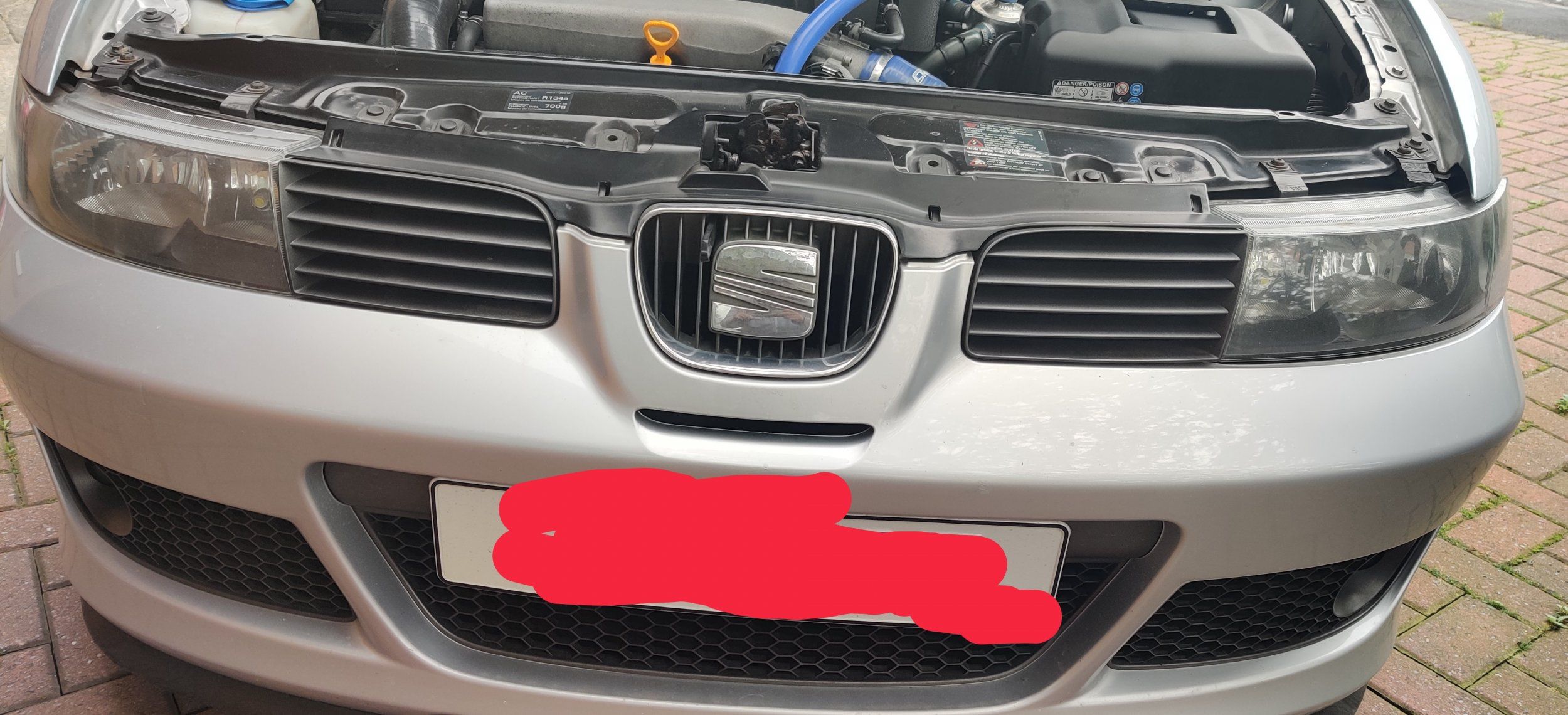

Need pictures off the whole front and even take one with the bonnet open as the slam panel may not be lined up correctly for them to be that far out

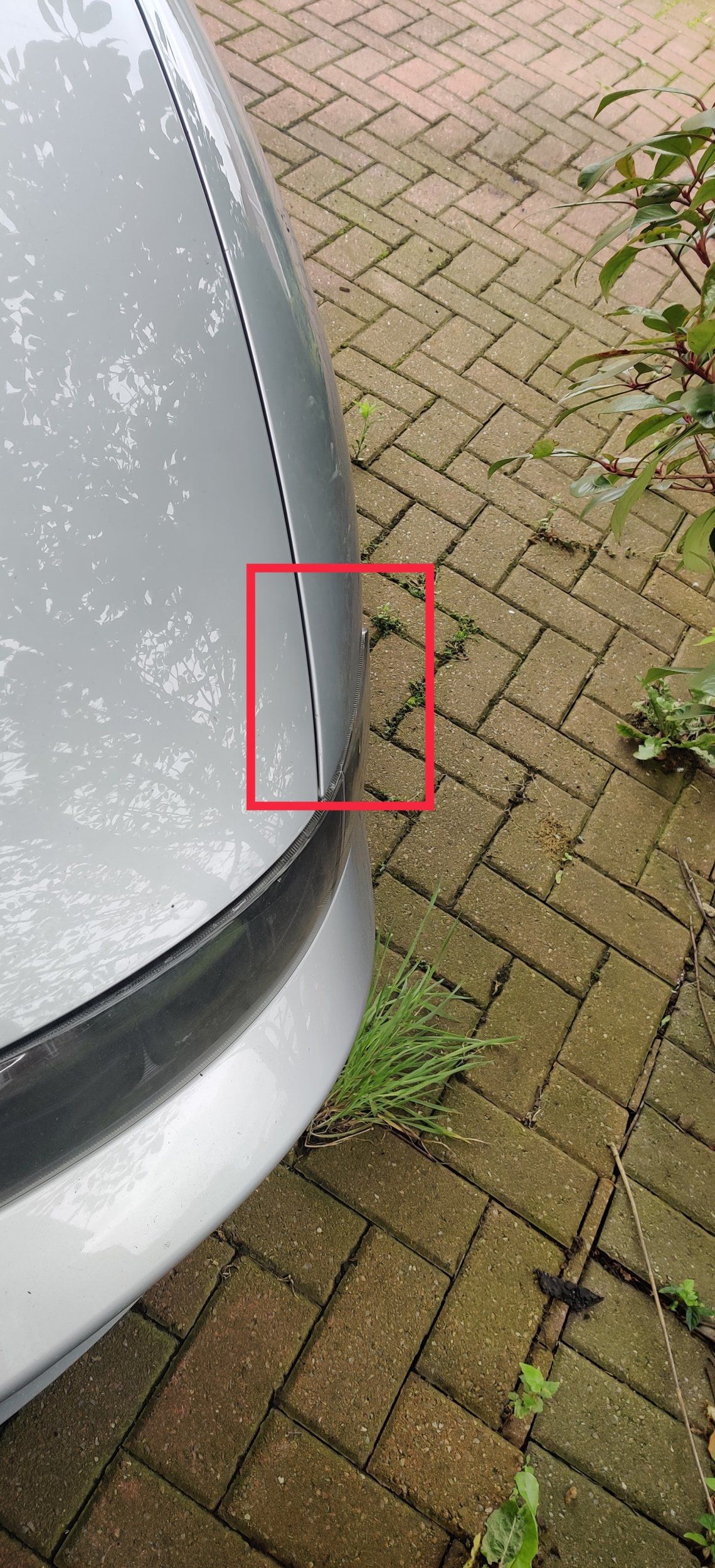

Hey bud sorry I just saw this. I'll move the car later get a better picture. The other headlight looks a little better but perhaps the opposite issue where it sits too inwards

Tried to get a shot to show both sides but tricky I'm no good with the camera . Could it be the slam panel need readjusting? How would I go about doing that?

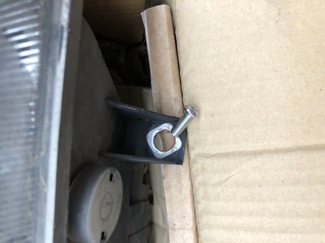

The lower tabs are the same hole size as the upper ones so there is at least a few mm of left/right movement with the m6 sized bolt. I dug a spare headlamp out and you can see how much play there is.
Worth a try with the bumper off.
Ahh perfect I think a combination of moving the slam panel and headlight will get me close thank you.
