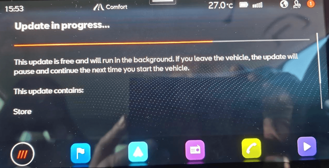

Hi all, quick question
Has anybody any problems with a recent OTA freezing at around the 60% mark? My 2024 (June) is seeing problems and I know somebody with a Born has the same issue. It keeps reappearing as an update but each time I try to install it just freezes saying "Update in progress....".
It says the update contains
Store
> Easily access the service revocation form by scanning the QR code in the Services Cancellation section
> Visual and technical changes have been made
Appreciate any assistance
Thanks
Dl

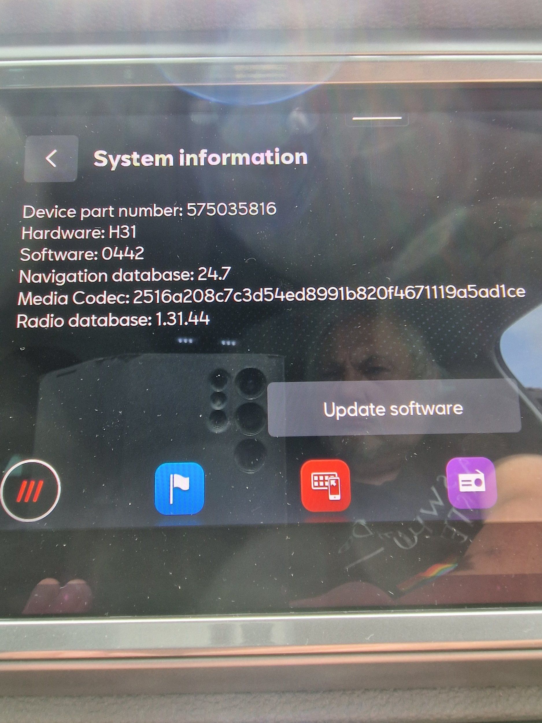

Go to settings, system information and take a picture

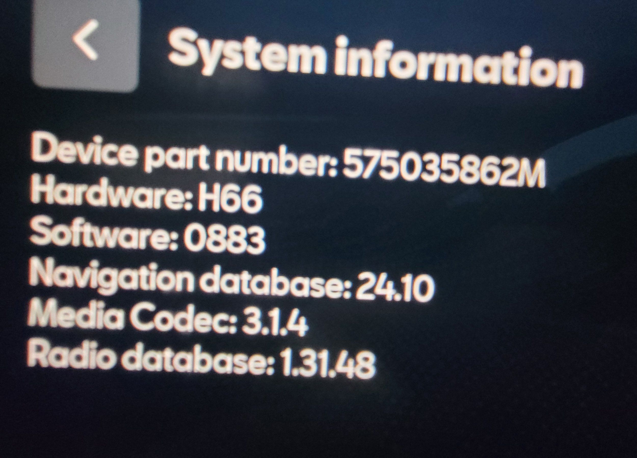

Do you want to do a picture of your infotainment system screen like the one above with the radio station release code. I'm wondering whether all Seat and Cupras are below the current Vag release which we know won't load on Seat / Cupra
Anybody got to that or above. That's v1.31.50.

Radio version is 1.31.48
Thanks for the serial number I'll see if I can drop my hand on that file from anywhere. Ofcourse it could be the release code of the logos rather than the delivery method from which they are packaged.
I seemed to have answered my own musing here:
So basically it's the release radio collection rather than the package. So you got a package in there that you can't get in off the VW / Skoda file, didn't do Seat / Cupra thou and has the missing stations. Crafty for Seat / Cupra to withhold the file from offline so connected only... but missing UK stations. There might be an offline Seat file somewhere that dealers have access to. Reckon it's got to have those 'SE's in it as I've said on the other thread. When you see them you know you are in business.
