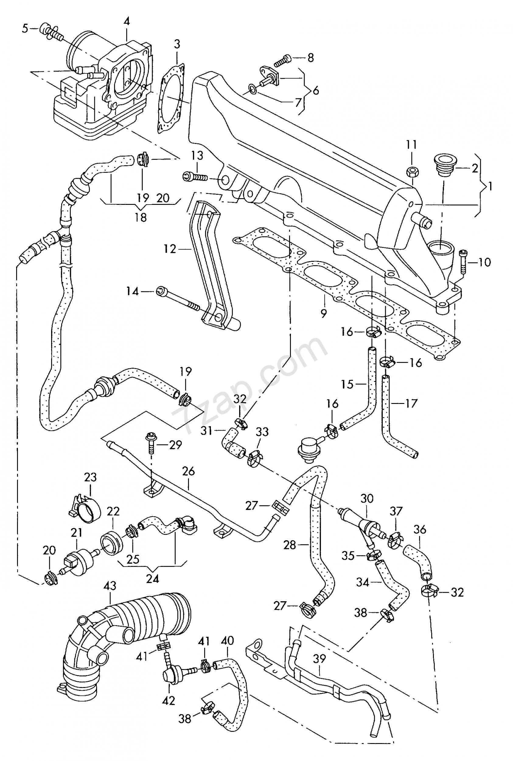

Hi wondering if anyone has a part number or any advice for injector cups for 2007 1.8t enge code bjx cant seem to find them correct for my car thanks
Sent from my FIG-LX1 using Tapatalk
Hello there,
Fuel Injector insert or cup
the part number is 06B 133 555H
(Number 2 in first photo)

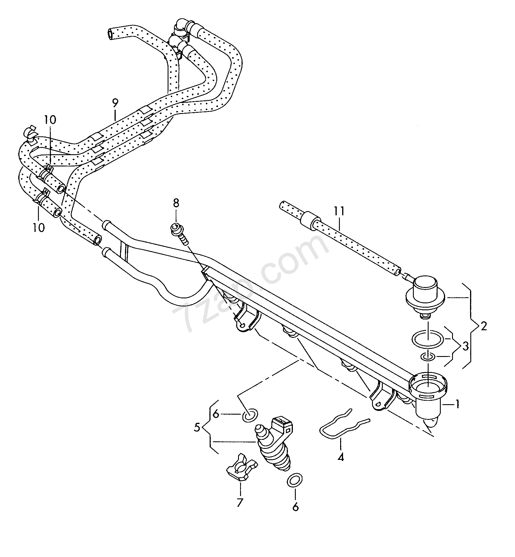

Item's below are from the second photo.
(1)
Injector rail
Part number 06A 133 329C
(5)
Fuel injector
Part number 06A 906 031BA
(7)
Retaining clip for above fuel injector
Part number 035 906 037
(6)
O-rings for fuel injector
Part number 035 906 149A
Hope this helps
