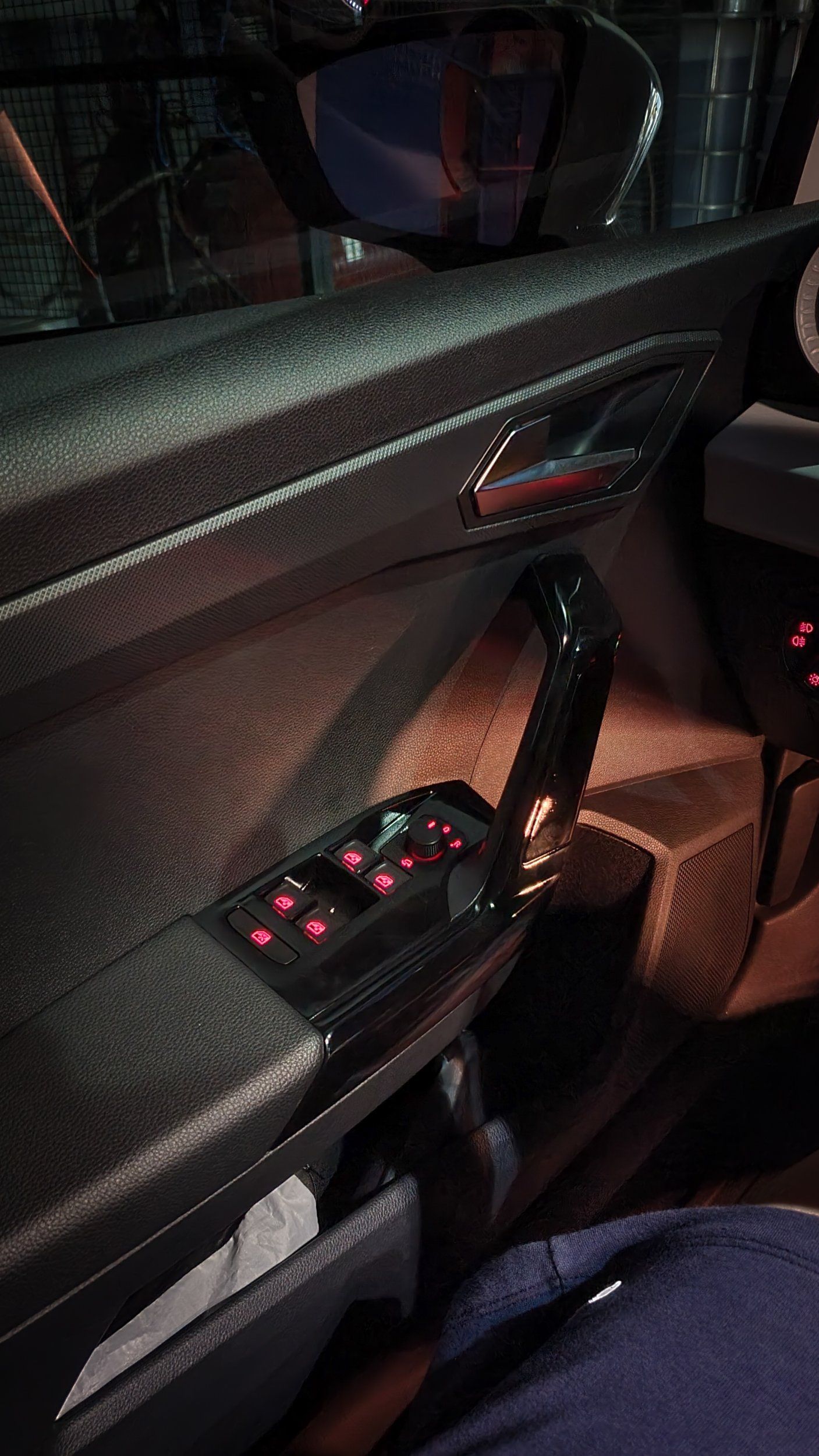

I was disappointed couple of days ago, when the inner door Handel scratched very easily when I was closing the door from my ring in hand.
I decided to take off my ring/watch when I enter that car ((
I will try to spray that scratch later on

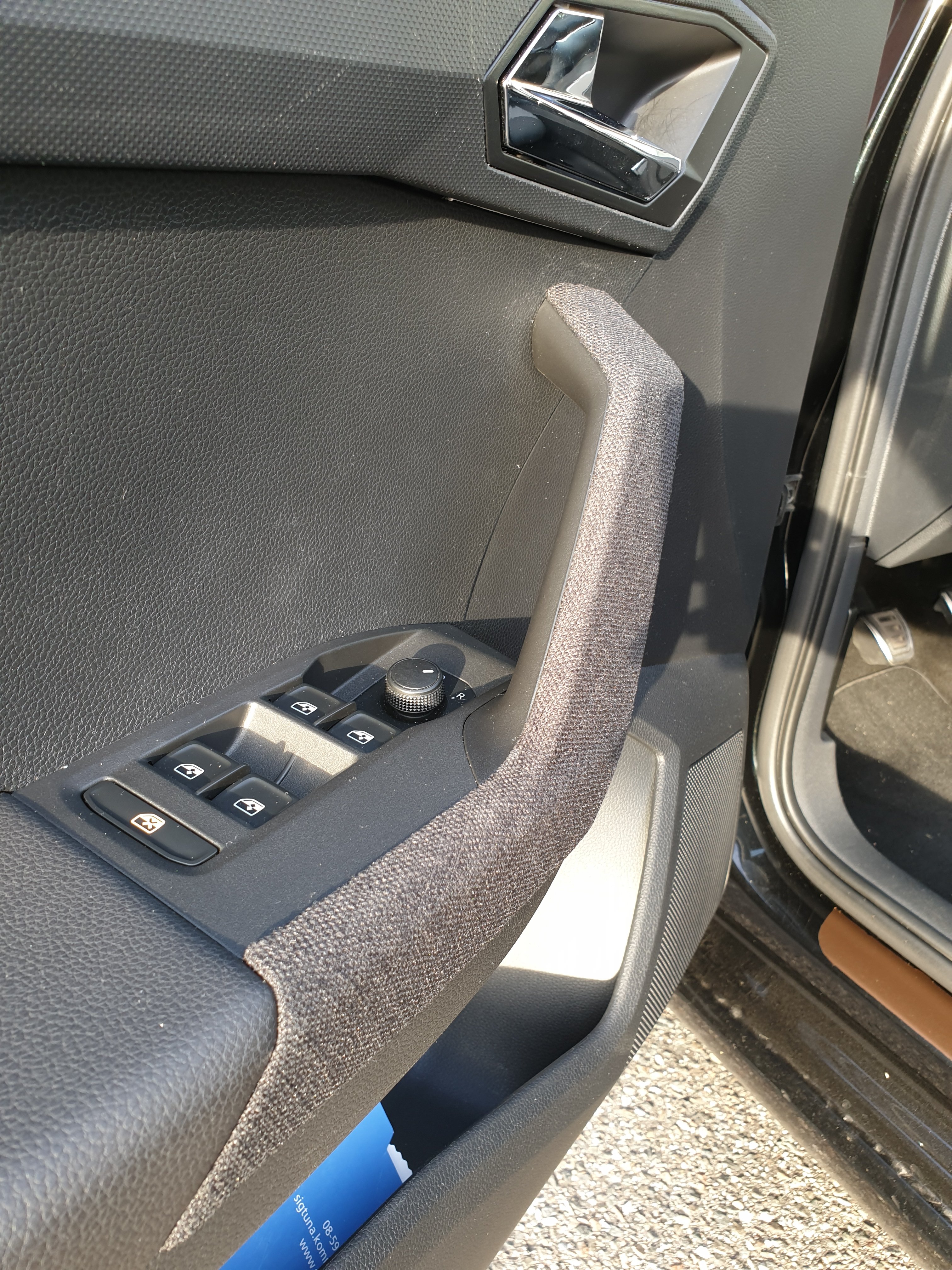

Hi guys! I went ahead and wrapped/ dressed the handle with a furniture fabric. It turned out better than I expected. I now get a more premium feeling when holding on to the inner handle. I used a spray glue can and just wrapped the fabric on top of the handle leaving very little of excess on the edges since the fabric I used is kind of thick it would not allow the handle to snap back if too much fabric would be stuck in between. Has anyone tried any other material?

Very nice work.... congratulations
