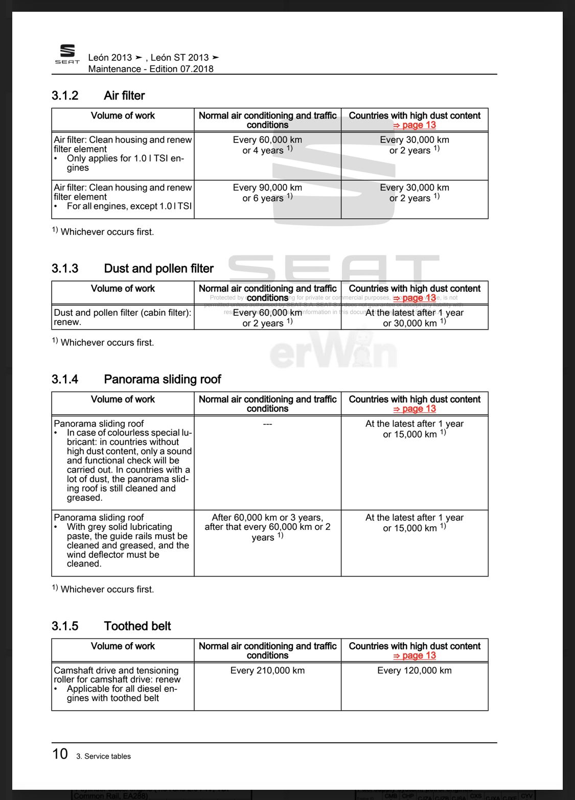

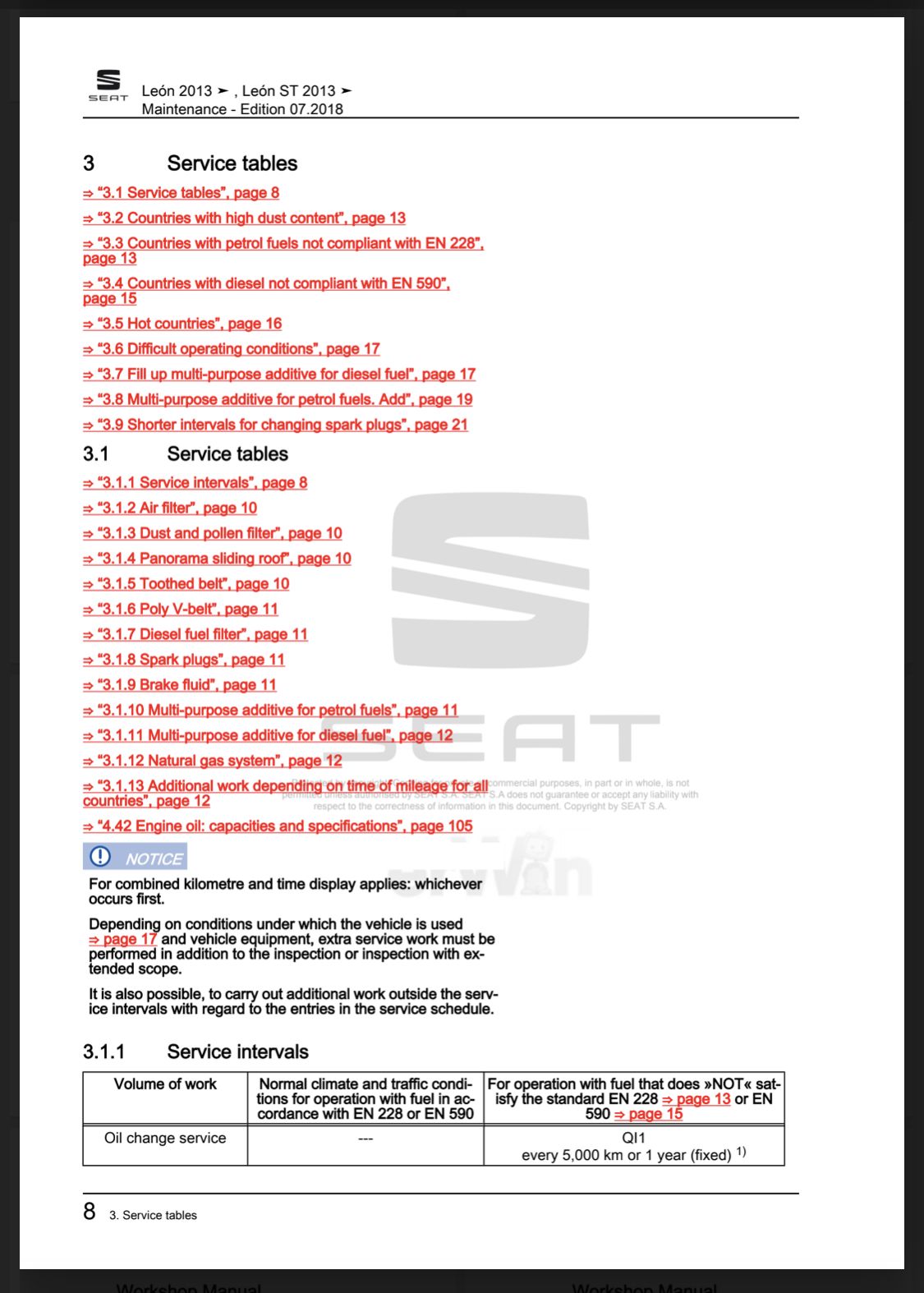

Under 6000 miles from new and only 2000 miles in the last year. I know oil & filter changes is essential but new plugs & air filter seems like an unnecessary expense given the low mileage.
However, I assume not doing the major service would invalidate the remaining warranty, and the extended warranty beyond year 3.
Also worried the dealership might charge for the major service but not bother to actually replace the plugs & filter.
