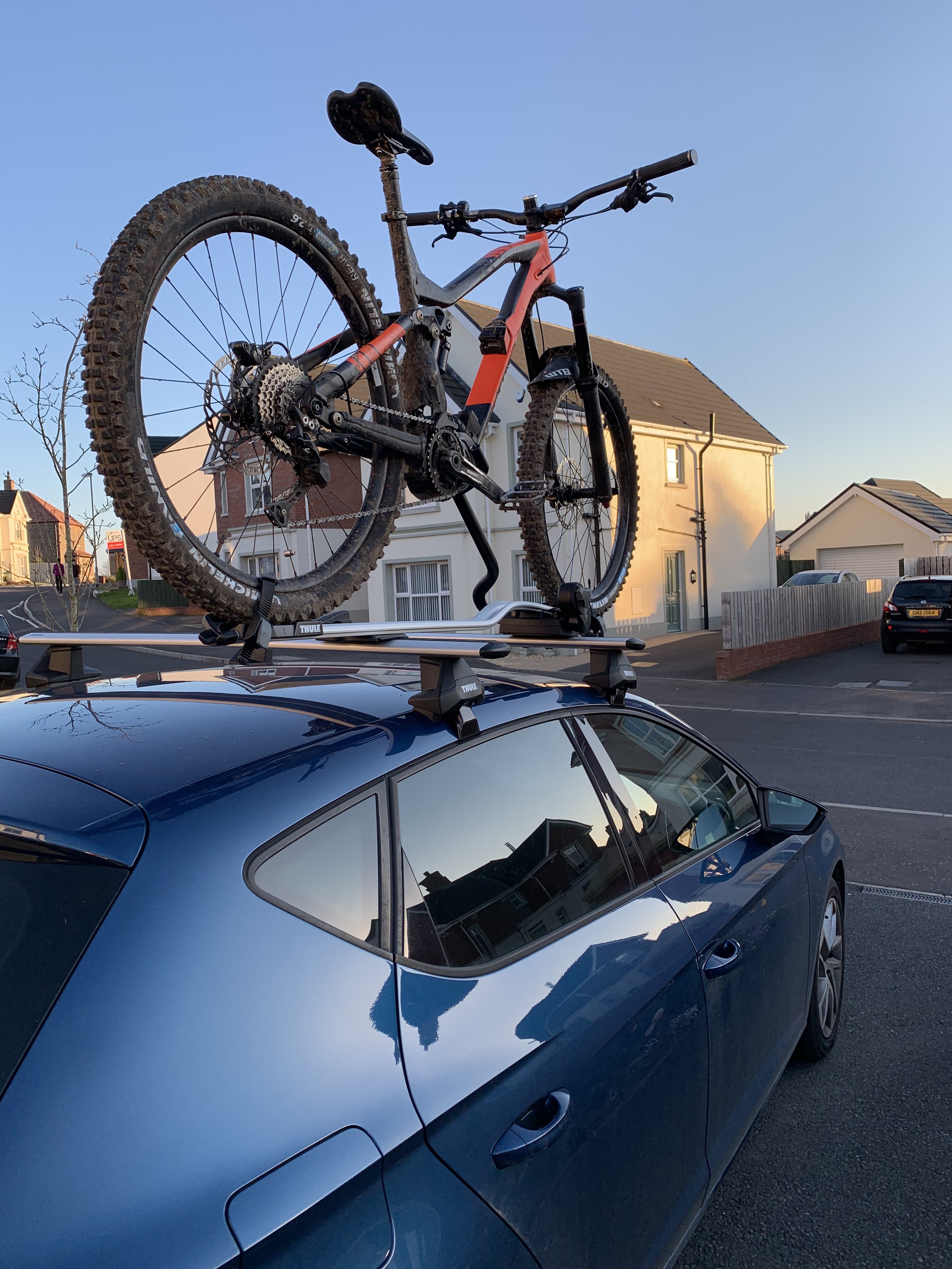

It's very unusual for me to break my OCD and not have matching everything (brand, colour etc)... If it was fitment to just the one car, then there was £5 difference between the Thule, Yakima and Whispbars (Yakima has now acquired Whispbar I believe) and like you would have selected the Thule bars, for the guaranteed fitment.
I do have the Thule Proride 598 in silver and black Yakima aerobars; took them out for a quick spin this evening and all is good.
Thanks for the input/assistance.

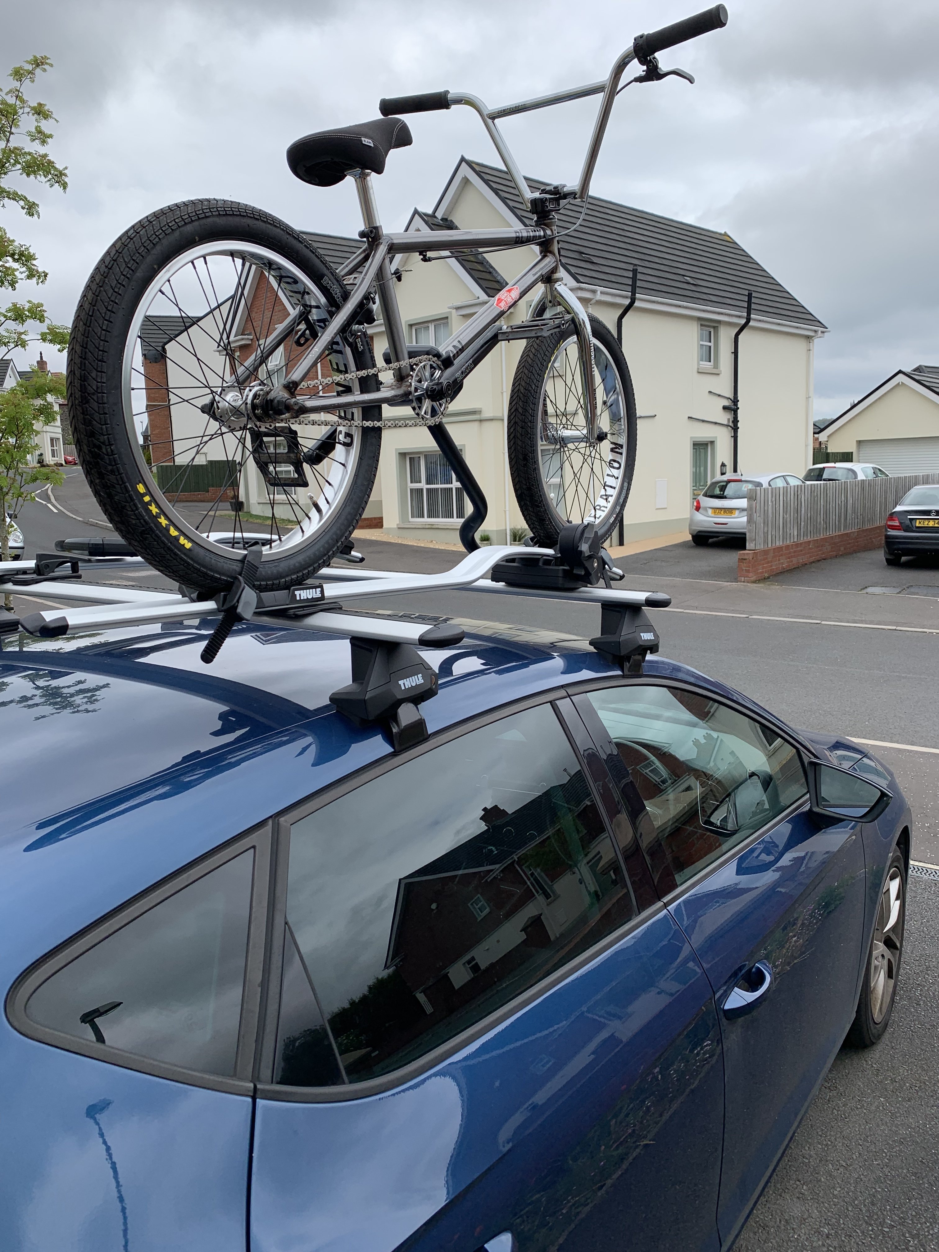

I have actually emailed Thule with some feedback on the 598 bars, they could do with being 6” - 12” longer to keep up with modern MTBs.
I have 2 more bikes I reglurary use and both are a bit long for the rack, if it was a bit longer it would be perfect.
