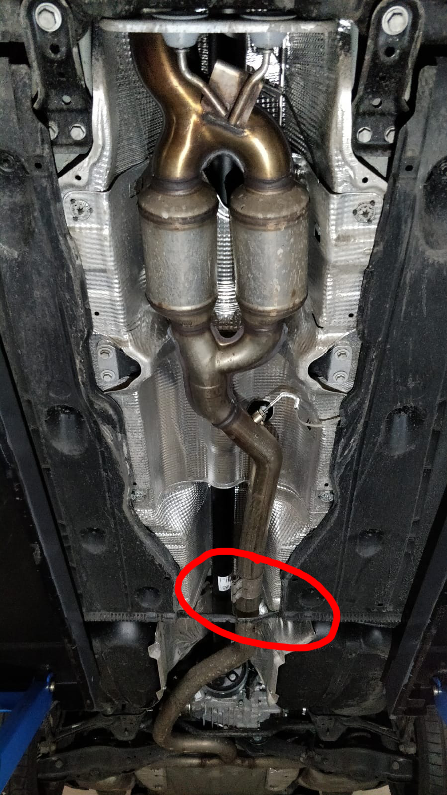

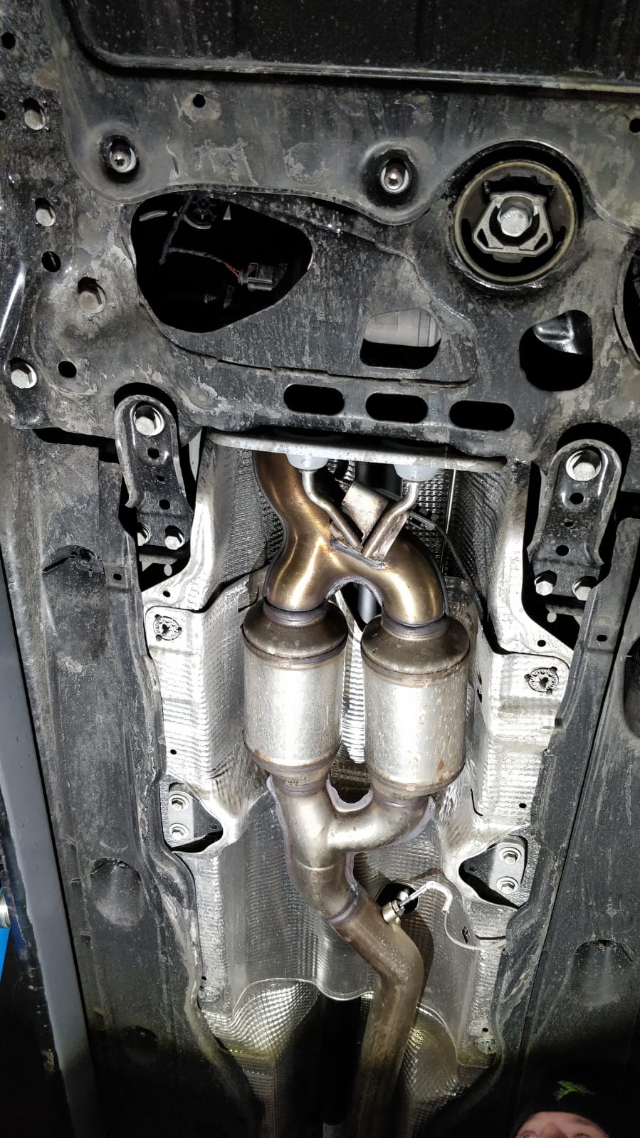

Took my new ST in for a Resonator delete today having purchased the Progressive Parts VAG Sport pipe well known on here.
There is a problem. SEAT have redesigned the resonator in the MY19 Cupra ST as per the two images. The single resonator on the 2018 model has been replaced by two smaller ones & the exhaust system splits. So the delete kit does not fit.
The guys at Progressive reckon it must but something to do with the new emissions regs & they said there appeared to be sensors in this new resonator part, possibly GPF related?
So in terms of getting a bit more noise from my ST without replacing the whole exhaust system I'm reconciled to a quiet car until someone comes up with a solution!

Interesting as it appears the resonator no longer exists. Only the GPF which goes to show how much noise/restriction they place on the exhaust system.

Based on the sensor, its as if they've dropped the Res altogether and those 2 extra bits are the GPF.
It does look like there it an extra join in the system though here...
So will need a 'GPF Back' exhaust going forward rather than a 'Cat Back' system.

As Damoh has said I think any changes to the exhaust will have to be gpf back. Which means you will have to alter the back boxes in all fairness the car will probably sound better with less drone.
The GPFs appear to be monitored by two sensors a temp sensor and no doubt a lambda. So removing them means either software hacking or some kind of hardware that fools the ecu. I’m sure someone is working to make them disappear.

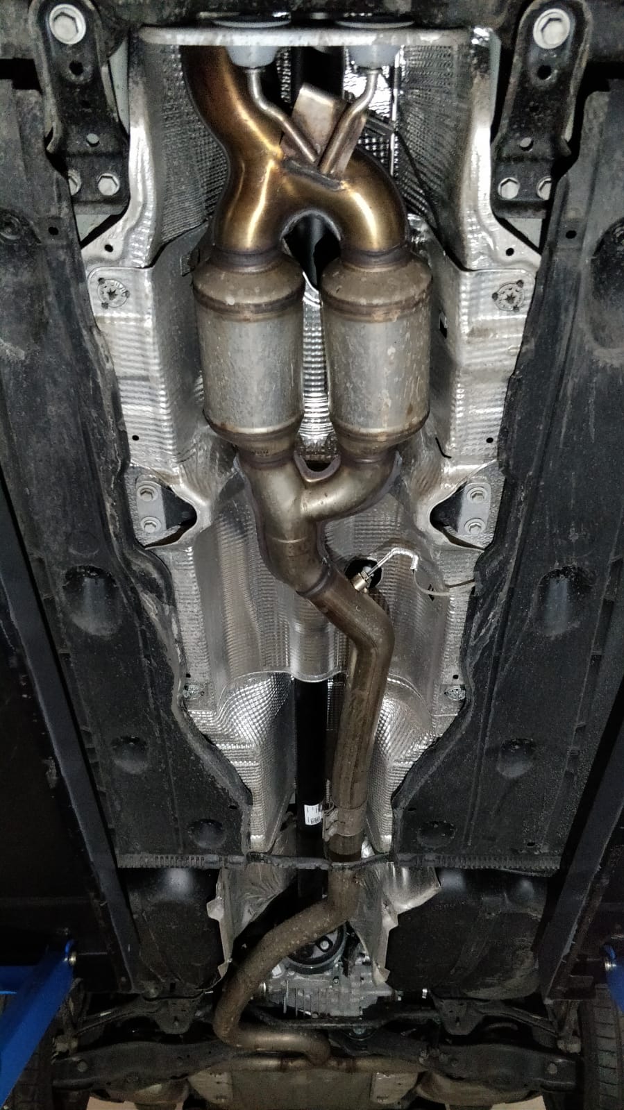

These are from the underside of the MY19 S3.
Same discussions over there.
It's a shame about the VAG sport Res delete as it was on the cards for me. It was just a matter of time. I liked ability to return to stock easily.

Looks like the S3 still has 2 boxes in series compared to the ST having them in parallel. So potentially could just remove the middle silencer for them.
Wonder what the 5 door Cupra has.

The GPF is straight off the turbo those are inline cats with an EGT sensor afterwards, exactly the same as my UP GTi
you can remove the cats and just refit the EGT and all should be fine but making up a replacement pipe is gonna be a pig

Double cats must be the only way they can lower the emissions enough for the ST and S3 to pass with 300ps and not 290ps as with the 5 door Cupra.
I think the 300 on the Golf R and Cupra ST 4Drive is more to do with the engine efficiency and burn temperature. Its always been my understanding that Turbo engines run more efficiently under greater load (Not to be confused with MPG just the bang for buck on the fuel burnt).
So chances are the 4wd system helps with the emissions, if not fuel economy, as its producing a hotter cleaner burn.
Need to see underneath a 5 door to see its setup. Surely someone with a new cupra 290 can get a photo from underneath the car by using a kerb.
