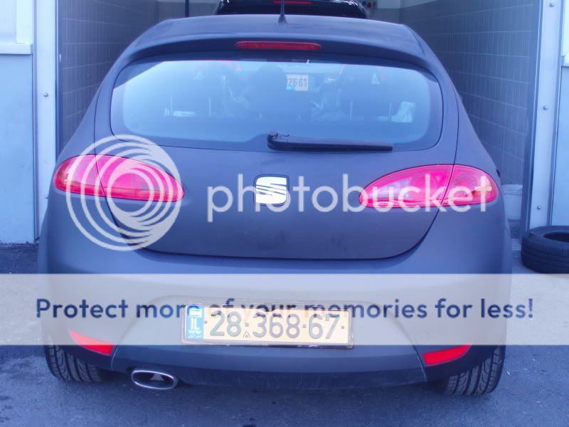

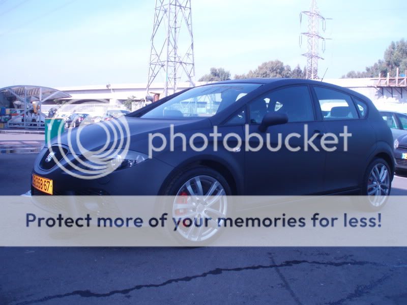

Hi ,
just got (few days ago) my new Cupra.
it has around 100 miles on the clock now.
had it painted MATTE black in the distributer.
painting had some problems so it is being re-painted.
but here are some photos , tell me what you think.

pics really don't do it justice.
once its re-painted i will try to get some better pics.
and also after it's lowered and got a normal set of rims.
i am getting in JAN a set of LM replica's 18X8 front 18X9 real and the centers are going to be painted same matt black as the car.
