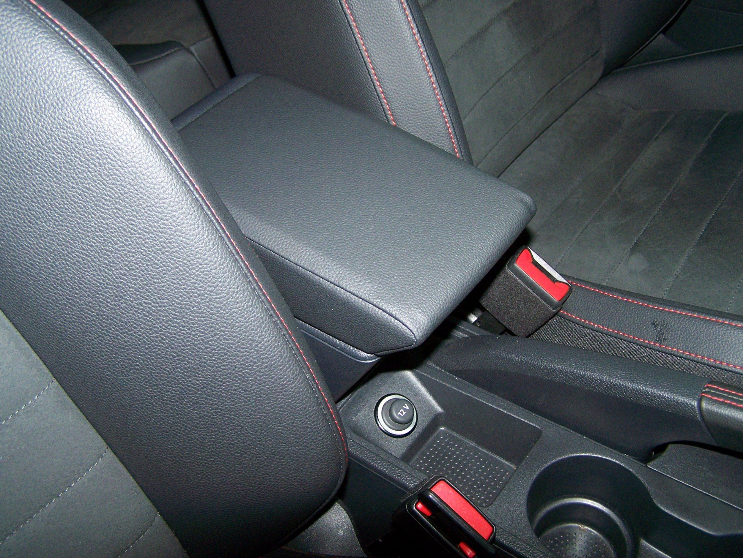

The genuine armrest takes literally 5 mins to install - must be 1 of the easiest upgrades so don't pay a dealer to fit it
I know what you mean about the doors - very tinny sounding which is why i fitted sound deadening pads inside the doors and behind the plastic door trims (also helps to quieten the rattles) - here's a guide for fitting deadening -
re your wipers - is your windscreen definately clean? use a good glass cleaner (i use Meguiars) or if none to hand vinegar is supposed to be good for cleaning glass. I noticed mine sounded rough last week so i clayed the windscreen before using glass cleaner - nice smooth and quiet now :)
Armrest fitted

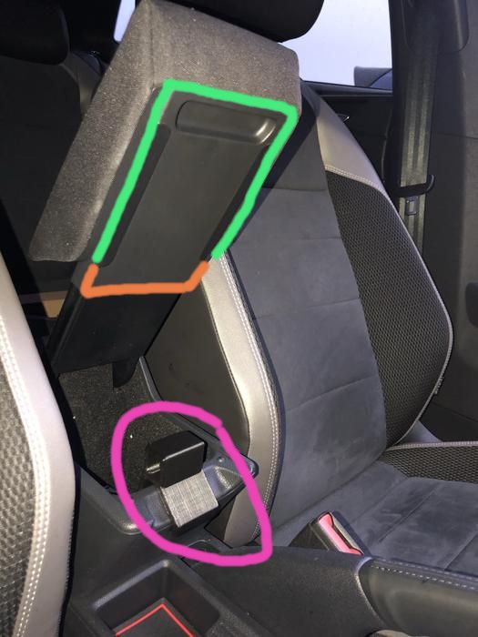

One question for the armrest owners... If you open the cover (the actual part where you rest your hand), does the underside of the cover wobble? I can see that it is assembled using the plastic clips that are supposed to snap in place, but it seems to me that the clips don't go all the way along the joints of the cover. Can anyone confirm. I will attach a picture of what I mean.
Green marks sections that are firmly snapped in place.
Orange marks sections that show a gap in my car causing rattle and wobble.
Bonus, pink marks someone's ingenious idea to 3D print a riser for the console. Model available on HERE :)

Mine doesn't wobble or rattle (one of the only things that doesn't rattle on the car), does it rattle if the lid is slid all the way back or just when slid forwards?

Agree about the plastic for the vents and the console dash in general.
FYI you can change the sound tone, volume and sensitivity for the parking sensors in the Car->Settings section.
My armrest is fine and doesn't rattle but it is way too low for me to even utilize it properly!!
Know any services that can 3D print it for me and send it over? As I sadly do not own one. Hopefully this will fix my issue and will be able to actually use the arm rest!
I've checked the armrest and its plate outlined in the photo, during this weekend. Turns out the brilliant officially licensed VW/SEAT/Skoda mechanics once more showed that they justify their existence and asking price :ROFLMAO: ...
Turns out they broke some of the plastic clips on that plate when they were servicing the handbrake :mad:. I have absolutely no idea why, since that upper part is not even a task of the disassembly process for the handbrake...
Any way I have ghetto modded some padding around the problematic / noisy area. Now it is a little bit sturdier and rattles less. Still not perfect, but its reasonable.
