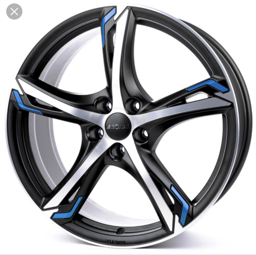

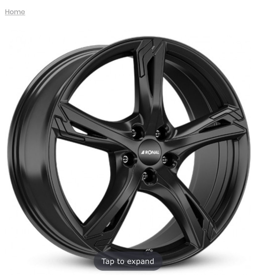

Change of wheels, looking at these as come in about £650, staggered fit so they’ll poke 3mm more than standard on the front and 8mm on the rear so should look slightly better than standard and not rub . Just not sure on the colour, the car is white, both the wheels can have the coloured insert in either blue, red, or green.
