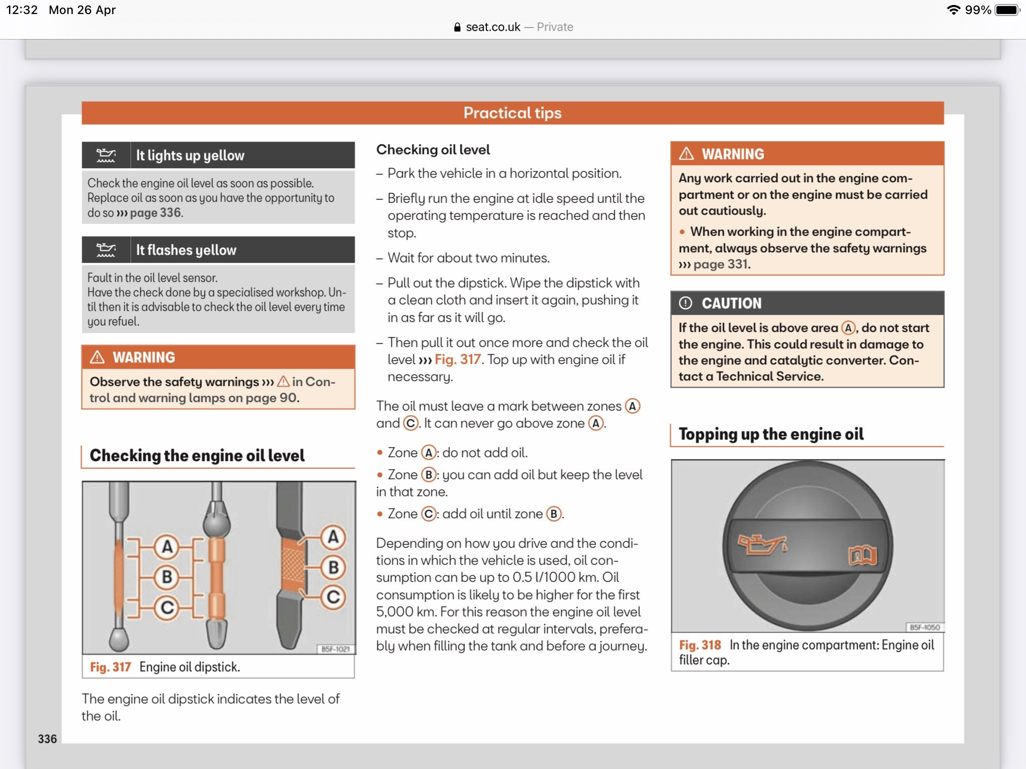

Hi everyone just after some advice. My cupra 290 is on a 2020 plate and has just covered 9500 miles. This morning on way to work got oil level warning light. Was in work within 2 minutes of the warning so let the car stand for 10 mins and checked oil. The diostick literally had a bit of oil on the bottom so it was extremely low. Luckily the petrol station sells recommended oil and I filled it up with a litre. The diostick is now just showing oil just within the recommended markings.
A.) any suggestions as to is this normal or not. My answer would be no BTW.
B.) no fault codes or warning lights previously and no visible smoke out the exhaust.
Any help would appreciated as it is concerning me
