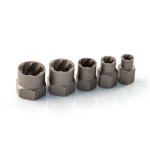

I think the bolts are M10 x 30mm and the hex head of bolt I think is about 16mm, so if yours are badly rusted like I've had in the past, they could well of rusted down a few hex socket sizes from 16mm to 14mm or smaller. There's a possibility one or two of them might need drilling out if they're heavily seized in.
You'll need a long 1/2" breaker bar and socket set, some WD40 or other penetrating fluid to spray the bolts in front and from behind.
The breaker bar gives you more leverage to undo the bolts, but once the bolts start moving it's also best to have a look at the back of splash shield, just to double check the whole bolt is moving and not only the head of bolt, if you know what I mean.
If you feel the bolt going tight when you're undoing it, this might be a sign it's close to snapping, so quickly turn it clockwise and spray WD40, then try undoing it again.
You also might need some special extraction sockets, these have serrated teeth that lock on to the head of bolt, but will only lock on in anticlockwise direction. Photo attached below.
The torque setting for these bolts might be on this forum somewhere, but if not I might have the info myself possibly, as I've replaced them on other VAG vehicles.
