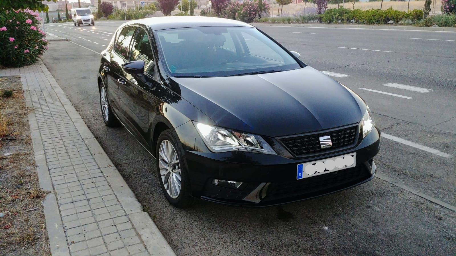

Grill surround back from the painter and fitted - now in a very nice gloss
Hey there, this looks sick and I'd love to do it to mine (we have exact same car, year and paint). I've removed the 6 rivets and can get my hand behind the grill but how did you remove the clips? I've tried pushing, pulling, squeezing and using trim tools but I'm still doing something wrong, the clips don't budge :(
Can't find this information anywhere on the internet unfortunately, thanks for the help!
