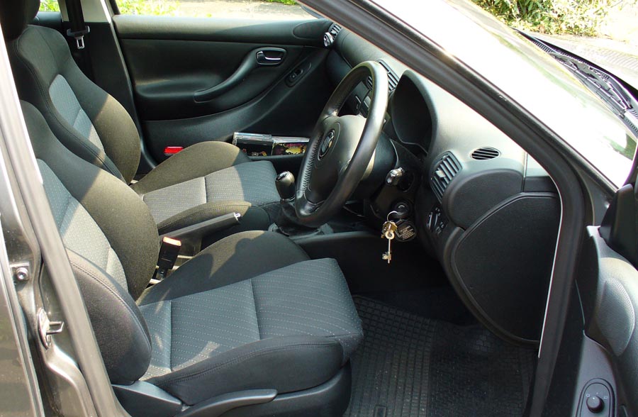

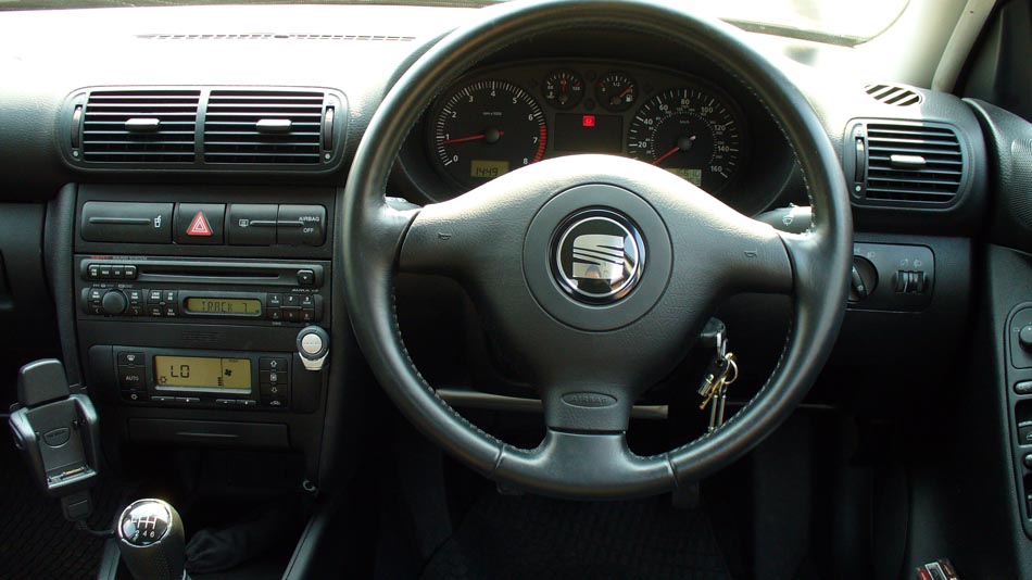

Here's some pics of mine taken not long after I bought it.
