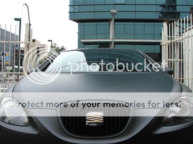

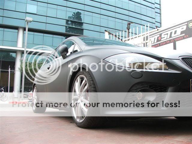

but I wanted my new toy to be special, and found a listening ear at the local SEAT distributer. That's why the car was taken with 10 miles on the clock directly to SEAT body shop for a new coat of paint.
once it got there the shop manager and Israeli VAG service manager immediately called me to a meeting , to meet the crazy guy who is going to do a paint job to a brand new car.
2 hours later and after signing a form declaring that I am the insane guy who needs to be committed and it's none of their fault the work began.
a week and a half later and after the arrival of a shipment from Germany of OEM Lamborghini Nero nemesis Matte black color , this is the result :

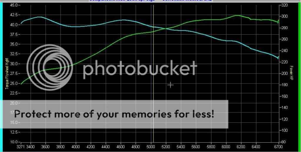

For stage 1 I just wanted to see how much can a software really do on those engines.
So a 10 minutes stop at the local APR dealer and Version 2.2 of APR stage 1 software for the S3/ED30 k04 cars is installed.
I then drove the car around 100 miles of to finish the learning phase and off we go to the dyno.
The Dyno I choose to use for this project is one owned by the local Sparco distributer who also prepares all of the rally teams.
The dyno is a Dynapack which measures HP At the wheel and is considered extremely pessimistic. All of the EVO and STI guys are spending their time in the local forums bitching on this dyno and the low numbers it yields.
So, the car goes on the dyno and here are the numbers :
Since torque is calculated in KG/M in Israel, in conversion to LB/FT it comes to 224 LB/FT.
So around 210 WHP and 224 LB/FT at the flywheel is exactly what the manufacturer prescribed , and estimated drive train loss here is around 12% which also sounds about right.
Ok, now moving on to the APR stage1 Dyno :
We did 6 dyno pulls on this since the numbers are unbelievable.
300.1 WHP and 304 LB/FT of torque
That comes to over 90 WHP and 80 Lb/FT of gain on just software.
completely stock car with just 500 miles on the clock.
Truly unbelievable numbers, and that's on a Dynapack , not some MAHA or a DynoJet.

Holy Jebus, Where do you live, I would most certianly like to dry hump it :cartman:
How much was the full body spray if you don't mind me asking?
stezo2k
Anjuna Monkey
Mar 15, 2008
2,804
Dudley
wow, that looks amazing
what a great job there :D
how much did that cost? i'm guessing it wasnt cheap considering its the same paint used on lambos
Poko
Nov 18, 2009
82
cost (in israel) was around 2500 pounds for work and around 800 pounds metrials.
