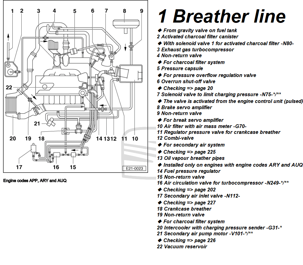

Difficult one, Have you checked the fuel system? If it's happening on all 4 cylinders it must be something common to all 4, so i think you can rulle out spark/ignition. Check the Charcoal cannister pipes are ok, valves are working and soleniod is ok. What are your LTFT and STFTs in live data.
I know you said you smoke tested the pcv system, but have you physically inspected the pipes for splits. Have seen it before where the splits only open up under vacuum/boost, and the smoke testers don't produce enough pressure to open the splits. There are also some one-way valves in the pcv.
