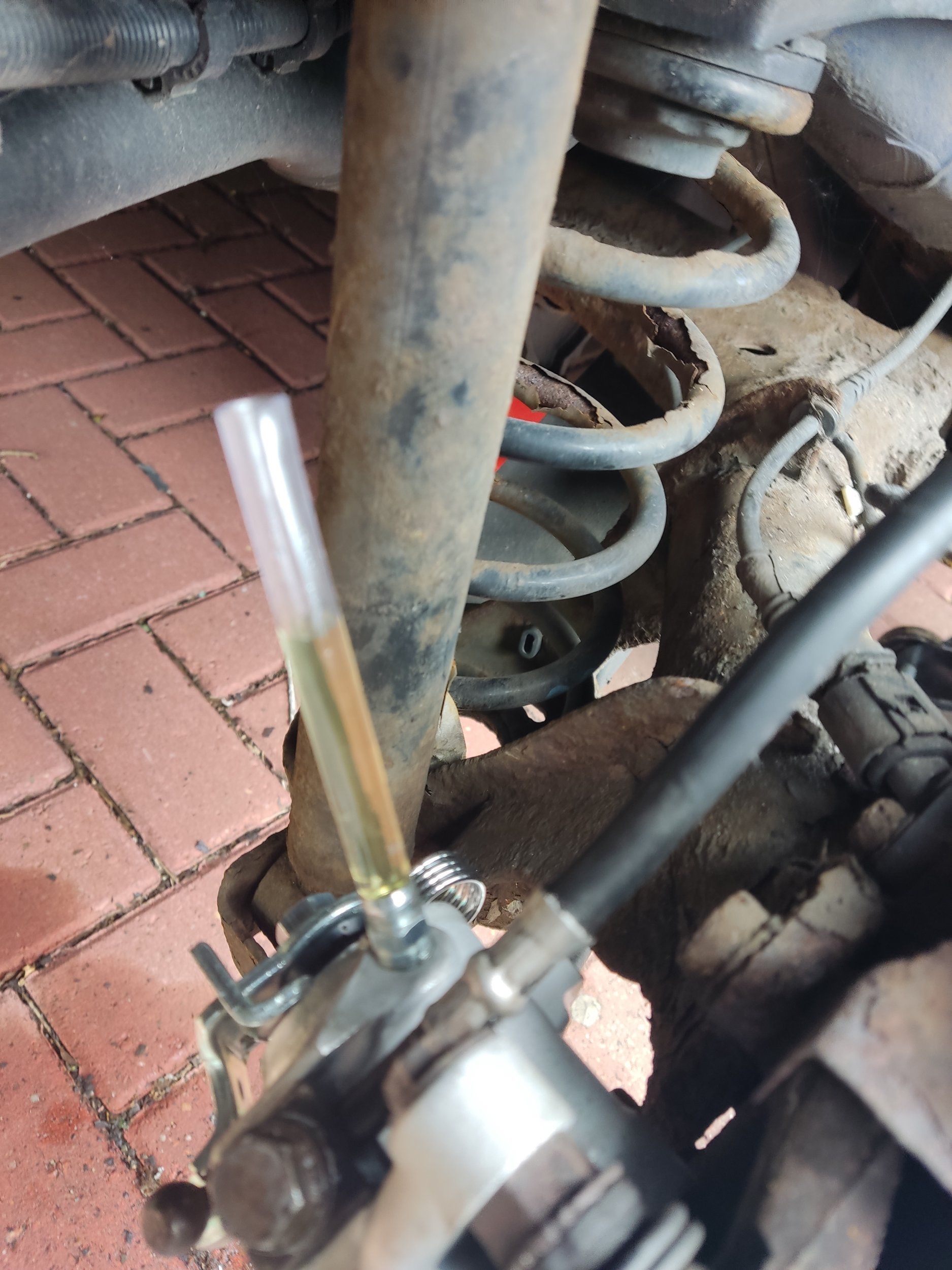

I have just replaced the offside read calliper using a technique I modified so I could do solo (in pic apologies for the state of it, been left standing for a long time) but the brake is still not working, I think I got all the air out as it stopped bubbling could it be the washers as I did not replace them? I didn't see any leakage so don't see how that could be the reason.
I did top up the brake fluid a fair bit don't think overfilled, not sure if that could be a cause, also when I turn the ignition I get a beeping and red brake flashing light which I have never had when changing pads before.
any help appreciated.

So if anyone else has this issue just top up the brake fluid I thought I had over filled but apparently not...
