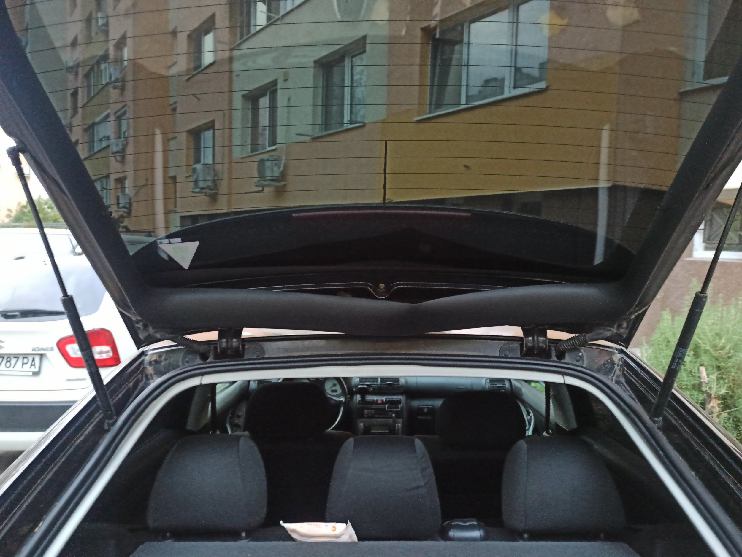

This is where I at , I see only 1 bolt at the center , I can't see those black caps you're talking about. Also thanks for taking time out your day to give tips

Thanks a lot , one of the parts that held the bolt was broken , which is why it was wiggling around.
