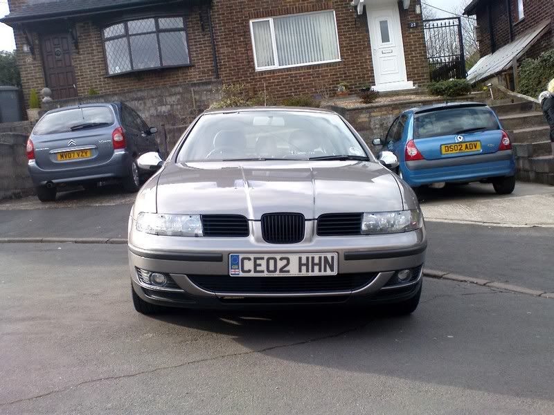

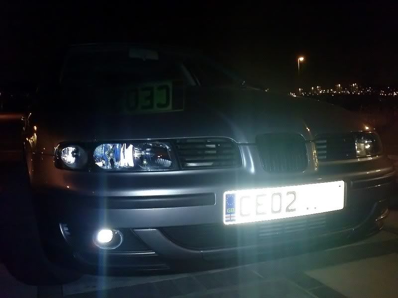

Fitted a set of fog lights today. Was a right nightmare to do. Found more work that needs to be done to the car once the bumper was off :(
Pics (will post better ones once its light)
Rookwise
Meeeep Meeeeep !!!!!

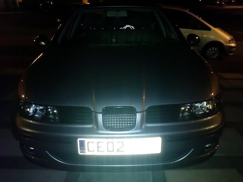

Crash bar needs replacing as the passenger side is dented. Probably explains the small outward facing dent just below the bumper trim. Nothing major though and hasn't affected the structure of the car any except that the bumper is about 2mm lower on the passenger side.
