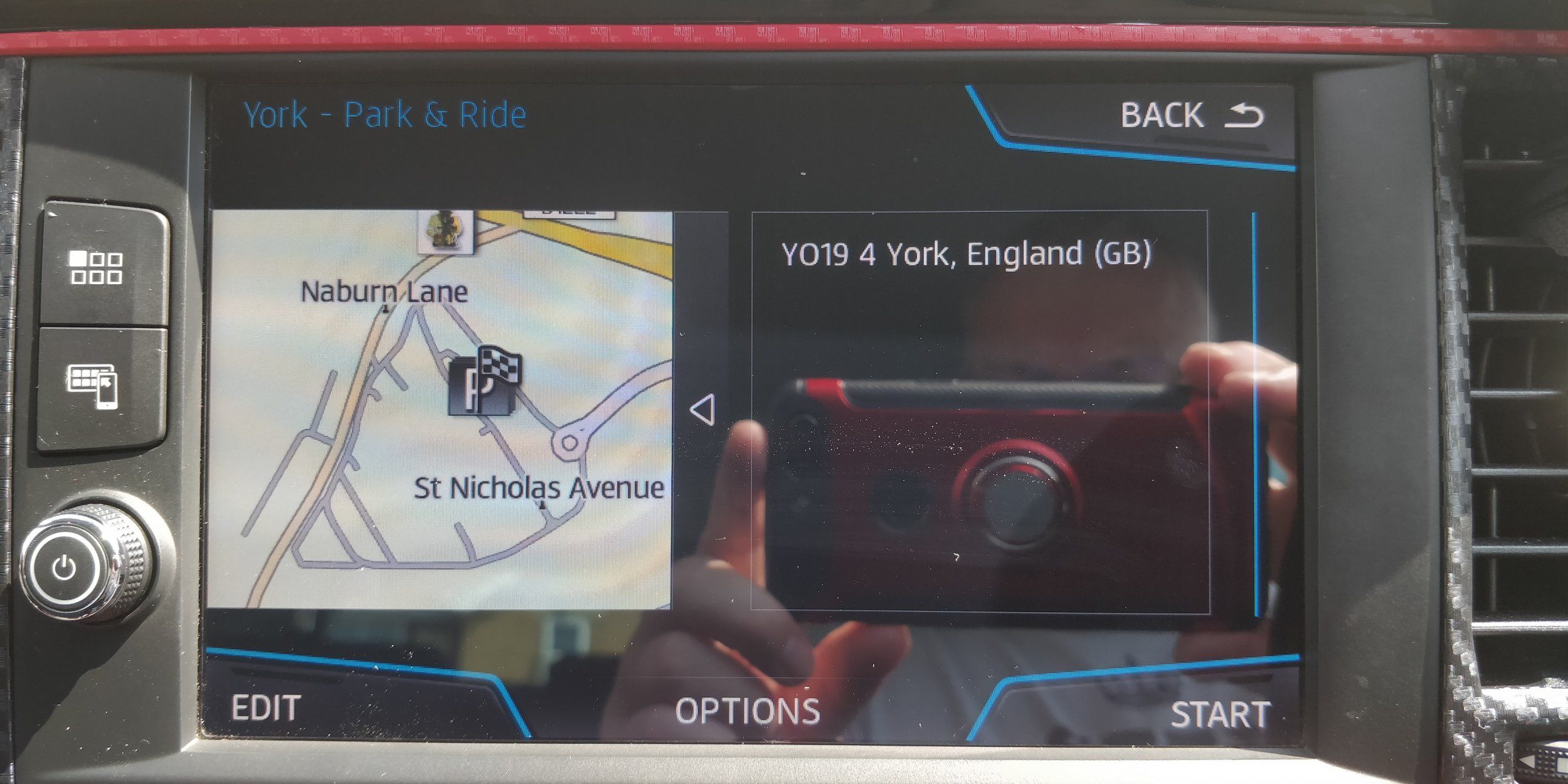

In this format..... if you select the name, it goes straight to the map giving the three route options. If you select the triangle to the right of the name you get this screen and options.... selecting 'Start' takes you to map again
