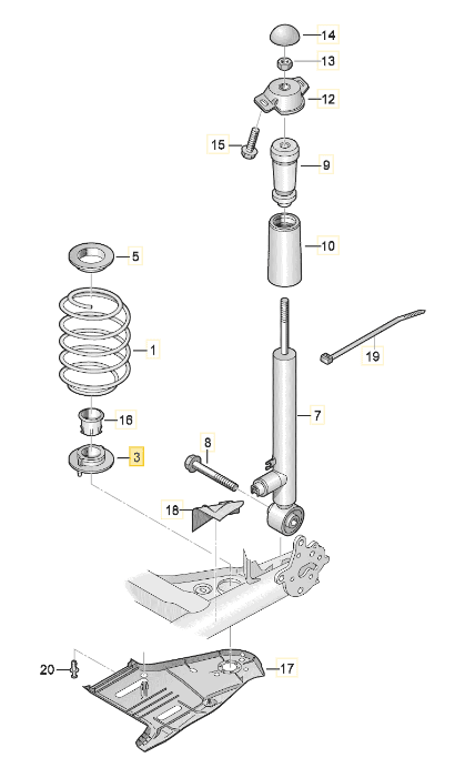

Hi , While changing my rear wheel after a puncture I heard a bang and noticed the rear coil spring had came off and landed on the floor.
The car had previously had a new spring fitted a few months ago , I then noticed the upper spring rubber mounting was missing , So they had not fitted it back when replacing the coil spring ? Would the missing rubber have caused the spring to fall out ? I had jacked up the car with a trolley jack situated on the jacking point on the sill as stated in the manual. The garage don't want to know what advice does anyone give should I take it further ? The car is now booked in to my regular garage to have the mounting rubber replaced.

There should be an upper and lower rubber spring support. Number 5 & 3.
The spring should not be able to fall out by simply jacking up the car.
upper 5Q0 512 149 F
lower 5Q0 512 297 D
