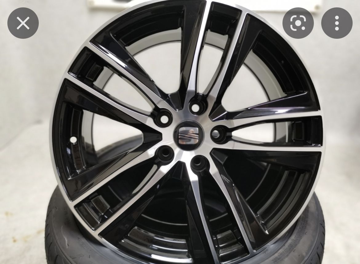

Hi all. I was wondering if anyone would know whether Seat Leon Cupra 19inch Alloy Wheels (8j 5F 5F0601025AC) would fit a 2019 Ateca? And whether anyone has done this?
If you want something to go by then the Carbon Edition / Cupra R wheels on the Leon were also fitted to the Cupra Ateca. The offset is et 45 and those Cupra wheels et is 50. There is no other difference I'm aware of.
