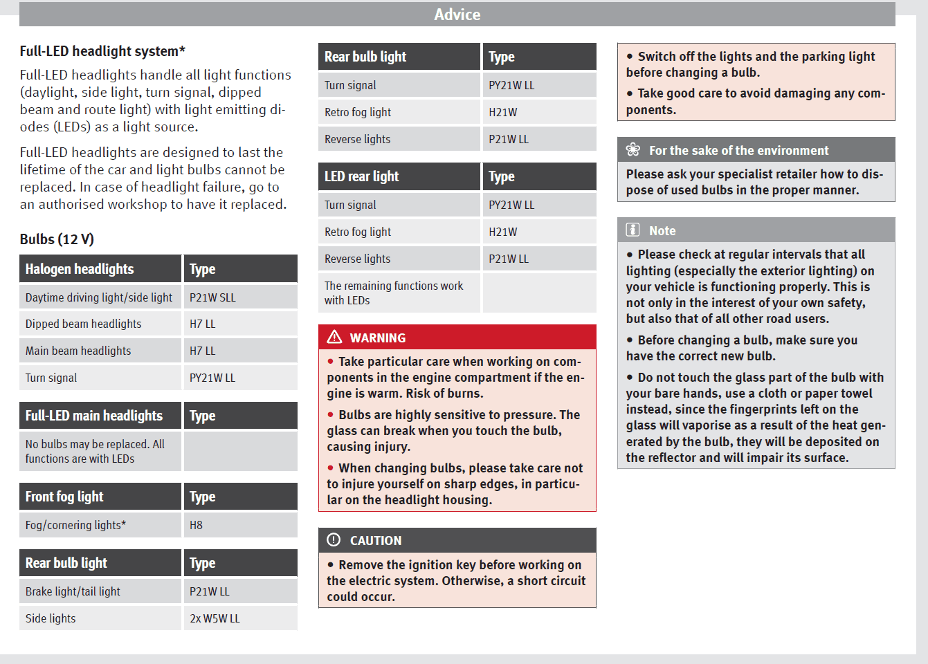

Yeah, most early Leons had LED in the UK as a "Free" extra.
Looks like I was wrong, I was sure the indicators on the earlier front LEDs were still bulbs (Rears where as I replaced them myself).
But according to the manual, even the pre facelift was full LED at the front. This is the page from the 2015 Leon Manual:
So sadly I think apart from checking the wiring and connection, it is likely you'll need a new light. You maybe able to get a refurbished one to save some £££.
Reactions: Goldie71
Looks like I was wrong, I was sure the indicators on the earlier LED were still bulbs (Rears where as I replaced them myself).
Yeah, I thought as much, I’ll get looking. Thanks Damo
