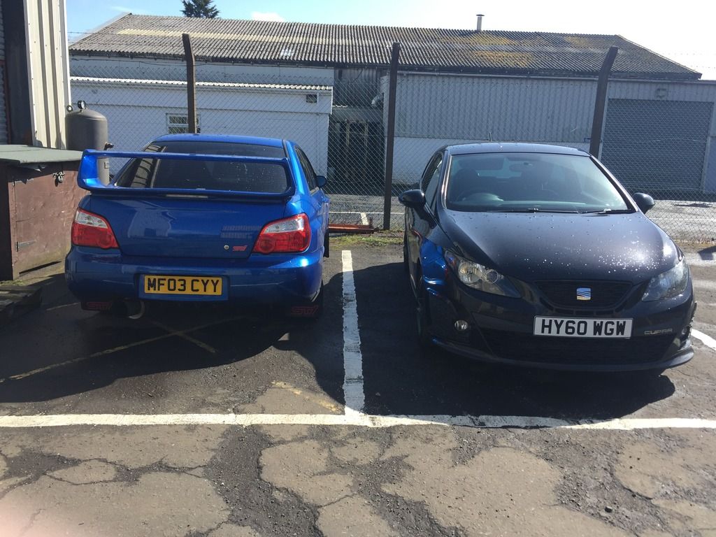

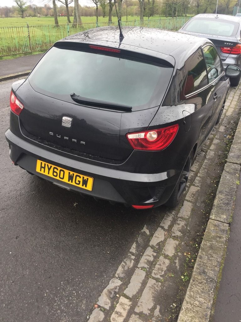

Hiya guys,
Recently got myself a wee Ibiza Cupra 1.4Tsi as a daily, :D
I also have a Subaru Sti, [B)]
What should i look out for i have read the fundamental problems thread and as my car is an early one i am worried it will blow anytime i floor it ? :(
Looking to keep it pretty standard apart from the current mods which i think is just a set of H&R lowering springs, but always curious as to what i can do possibly upgrade the brakes i read the 225bhp Leon Cupra R brembos are a good choice, are there any breakers on here ??
What about the rear brakes ?
Which sites are best for parts such as servicing filters, OEM waterpumps, timing chains ?
How do these cars handle a stage 1 map, would be an APR ?
The DSG box is great, is there any upgrades for that, or service parts ?
Thanks

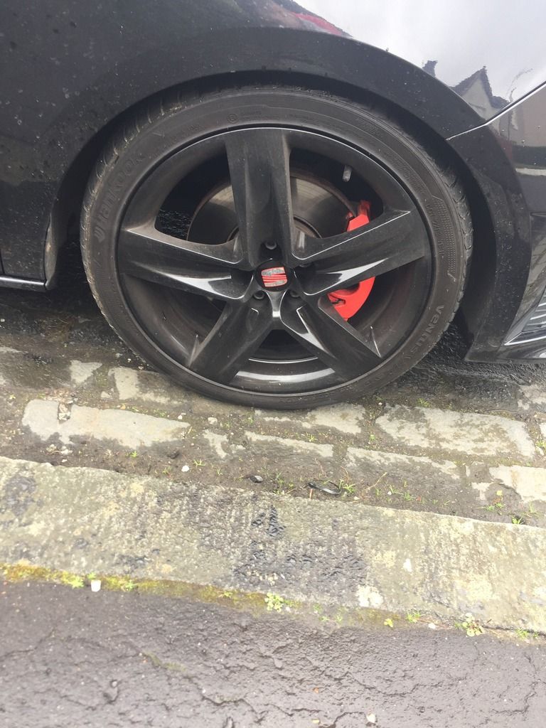

Cheers bud,
I see you run the old BAM Cupra R brake setup,
What was involved with that front and rear ??
I would like to go down this route,,
Will i need spacers for my stock 17" wheels ?
How does rear h/Brake setup operate on those bigger back brakes ???
