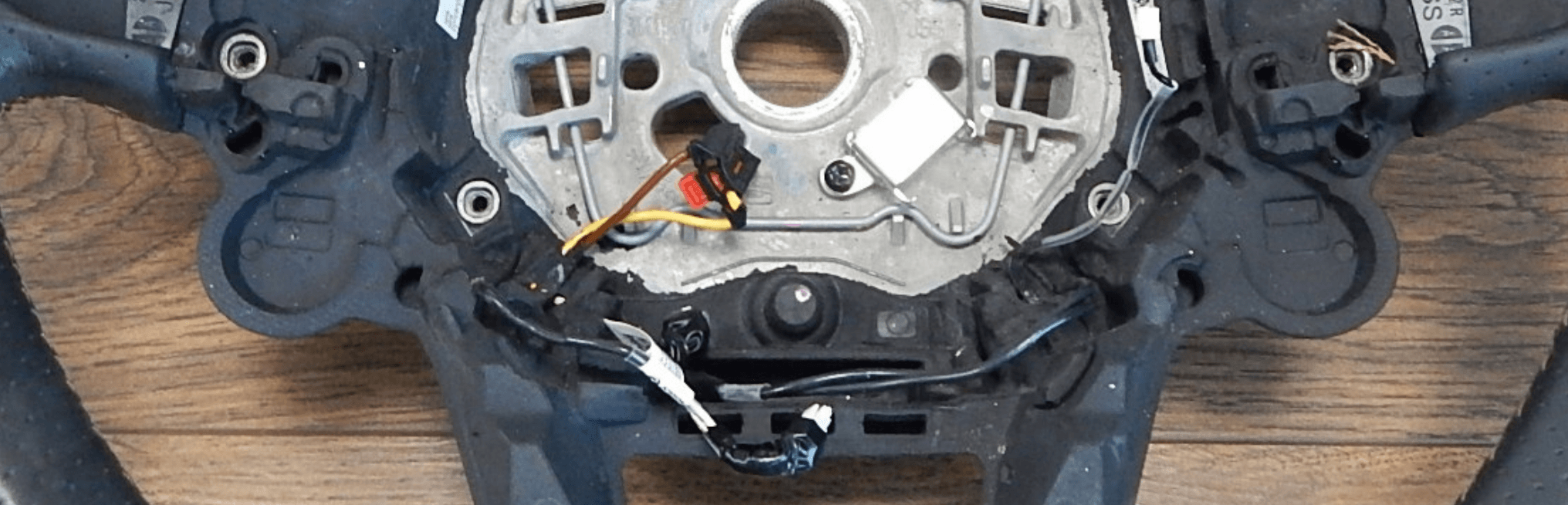

I updated my steering wheel for Travel Assist. The Start Engine button on the steering wheel works, but the Drive mode button does not. The button has no special physical wiring. It works over the Lin line.
I couldn't find any code.
Could you help
Could you help

Hope you could find the solution. Would you mind share with me where to get the buttons of logo/start engine please? Cause I’m thinking going after that steering but maybe get the version without the buttons so if there’s a way of later adding them it would be nice n’ perfect for my project idea
Sep 2, 2024
Any update on Drive mode button? Also have you repurposed start/stop button to ESP?

As far as I know, the driving profile button is, as already mentioned, a LIN participant. It is dependent on the control unit 19 and the data set. So if the button was not in the steering wheel at the factory, the data set for the control unit 19 is required.
