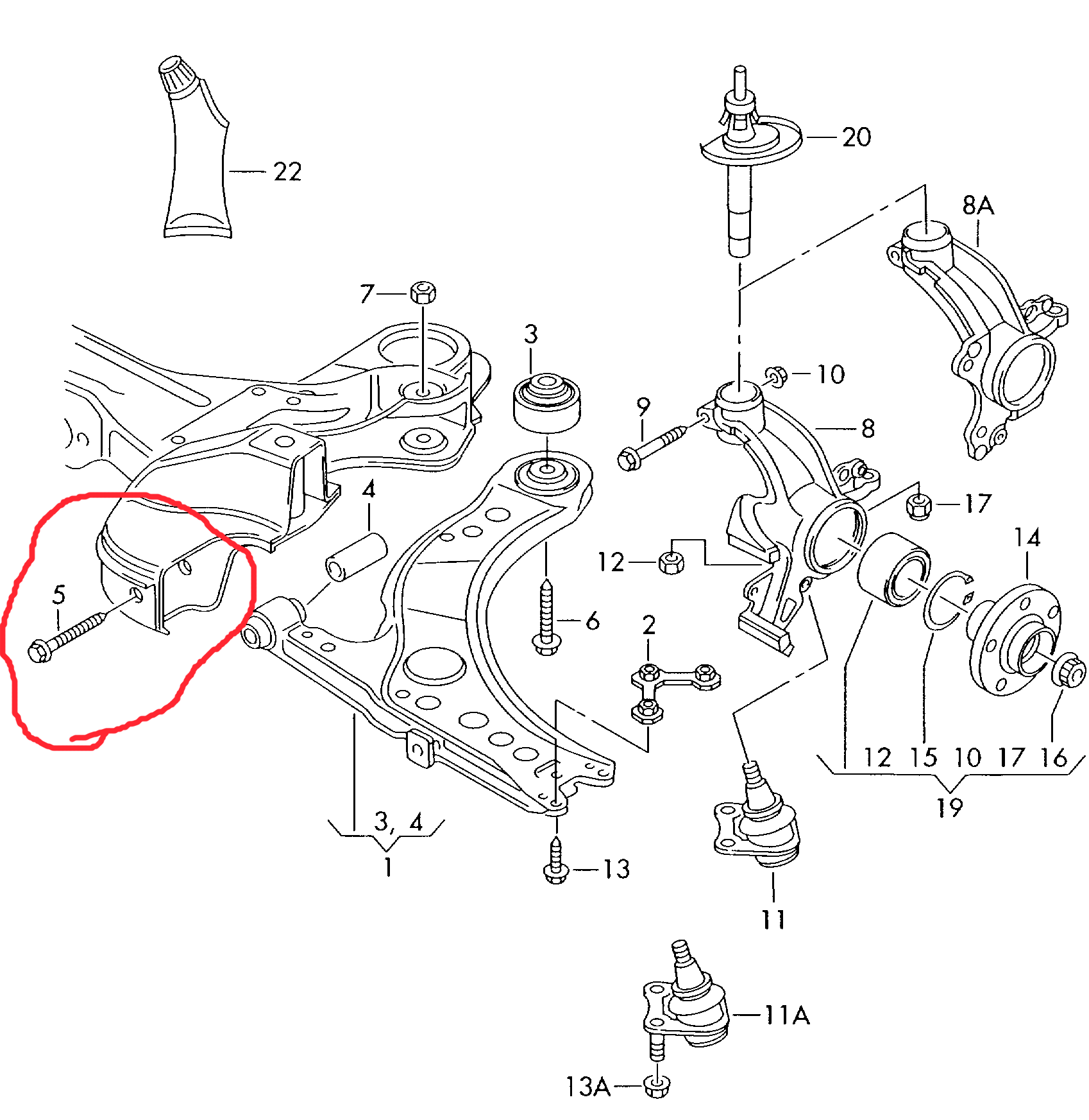

i have had the same probles as you describe , fasten the bolt circled in red both left and right side
