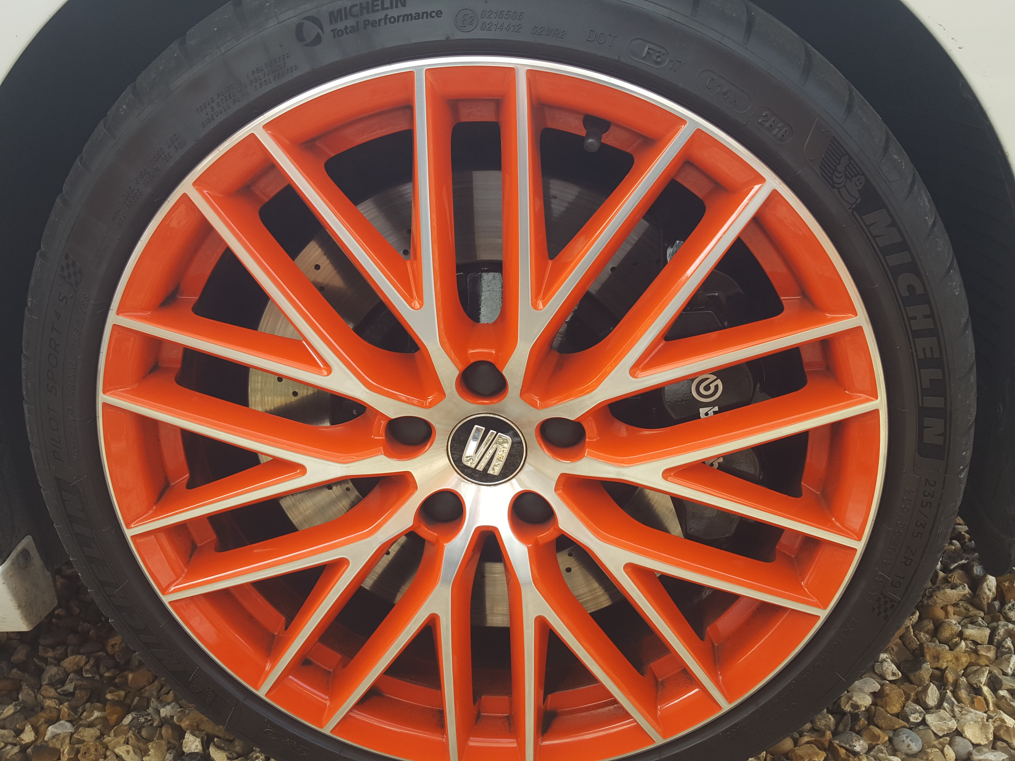

I hear what your saying but RS3 air ducts would sort the cooling and you can't really see mine anyway and your talking twice the cost so you could buy 4 instead of 2 .
