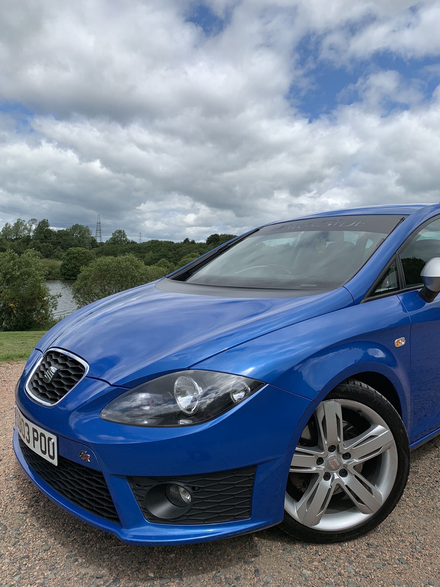

Attached only pics I currently have.
Plate is private and a joke lol
