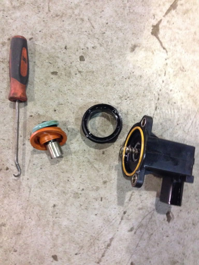

Diverter valve? Pcv?
This has only been on the car for 2 months if that i know there are different revisions but which one should i go for any thoughts?
No happy, I just chucked the new diverter vavle on and now it's running very lumpy and poor on idle, I went under car to find the exhaust glowing hot near manifold
Turned the engine off and put the old valve back in and still runs like ****
The thing is it ran fine before just lacking power
Thoughts please
Right that was just me being a retard and left a Pcv pipe off, but just road tested it and it goes abit better but no way near I well as before :( I wonder if the valve is faulty? Are you sure that revision is ok on a k03
Yep this is the one I fitted
I have a generic diagnostics Kit with live data can't I just use that? So you think that valve is ok for that engine tps said that vavle doesn't match with your car,
